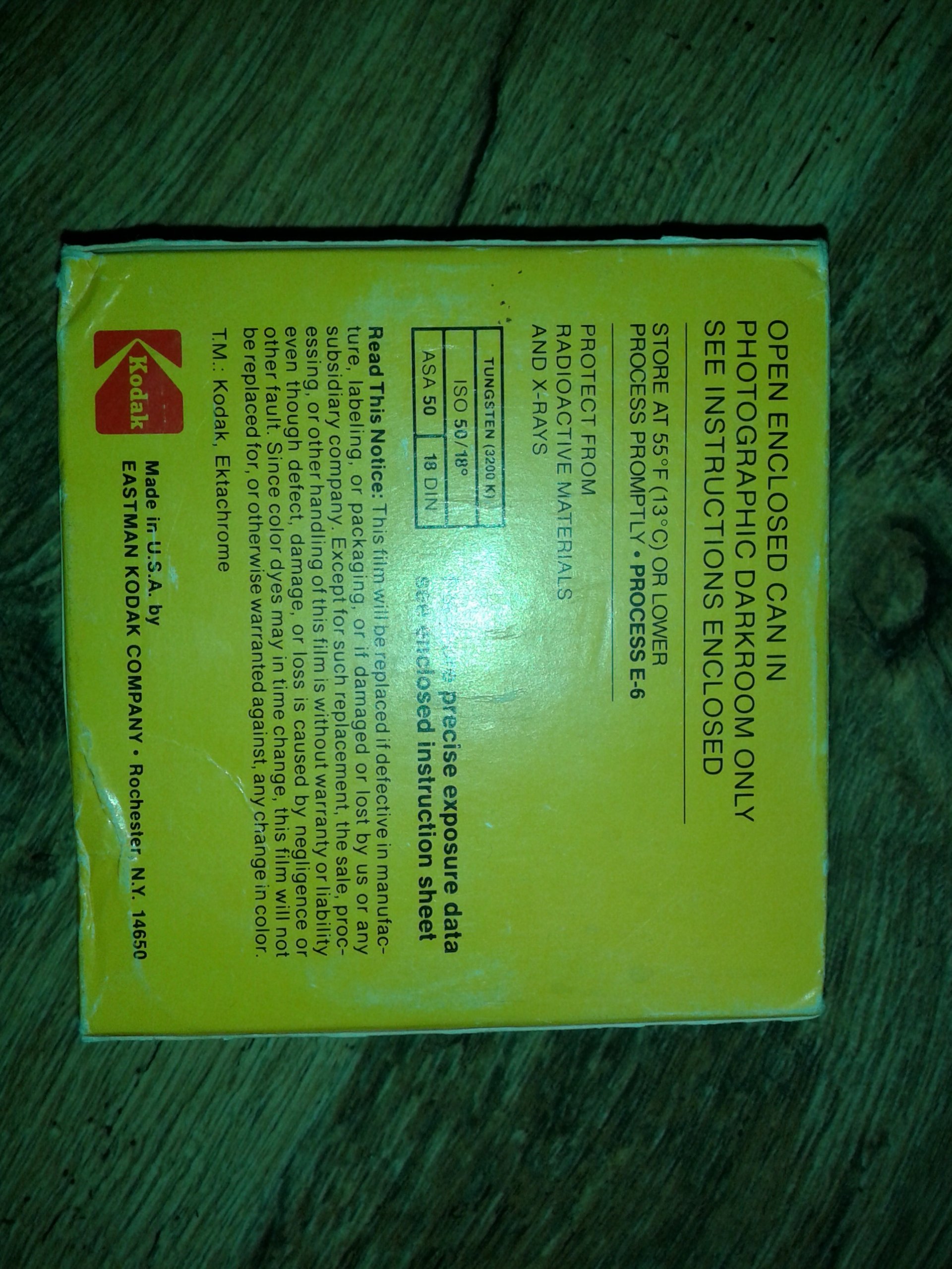

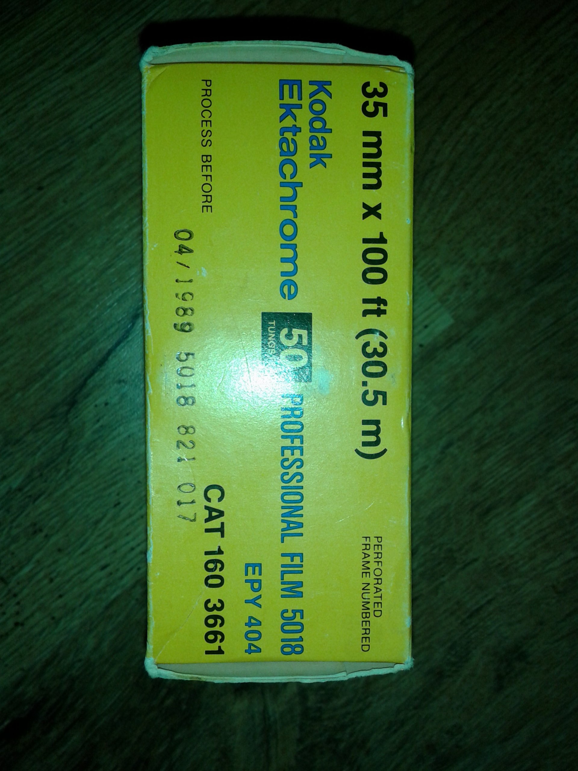

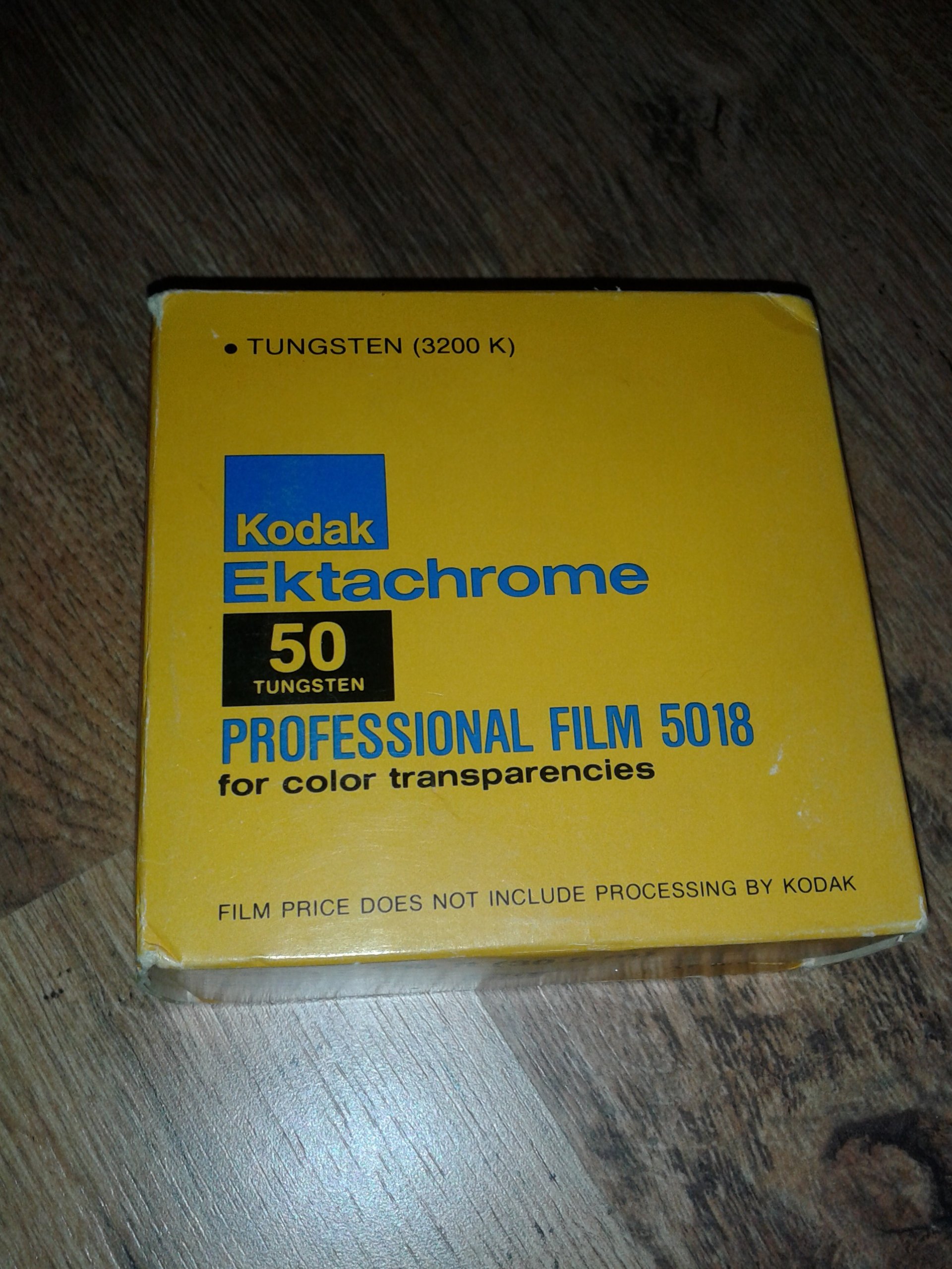

Here are the photos of the box.
Sorry about the crap quality, my phone camera sucks!

The T in the name indicates that it is for designed for shooting in tungsten lighting situations. Essentially indoors with incandescent bulbs. Slide film of that age is probably going to come out monochrome blue or red. lt might be scannable but will be worthless for projecting
It might be fun for us and cross processing, or processing with C 41 chemicals. The lomo kids might even buy it off of you if you hand roll it in charge 3 or 4 $ a roll

It looks like your box say for "3200K".
I thought that Ektachrome 64 was balanced for 3400K.
You can get Photoflood bulbs for either temperature of light.
TimFox
Jul 21, 2009
99
Chicago
No, it was Kodachrome 40 that was balanced for 3400 K ("movie light").
At the end of Ektachrome 64T (EPY), it was balanced for 3200 K.
