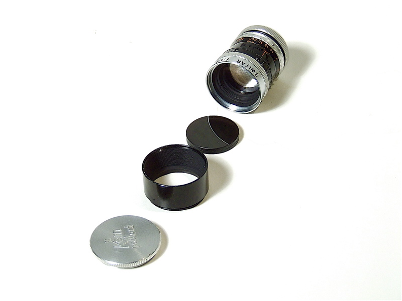

I have collected a bunch of nice ND filters to fit my Switar lenses, for use outdoors. Especially with dual-8 where I don't want to stop down past f8. I use the 0.9 filters (3 stops) in 'series' sizes that fit between the lens and the lenshood.
