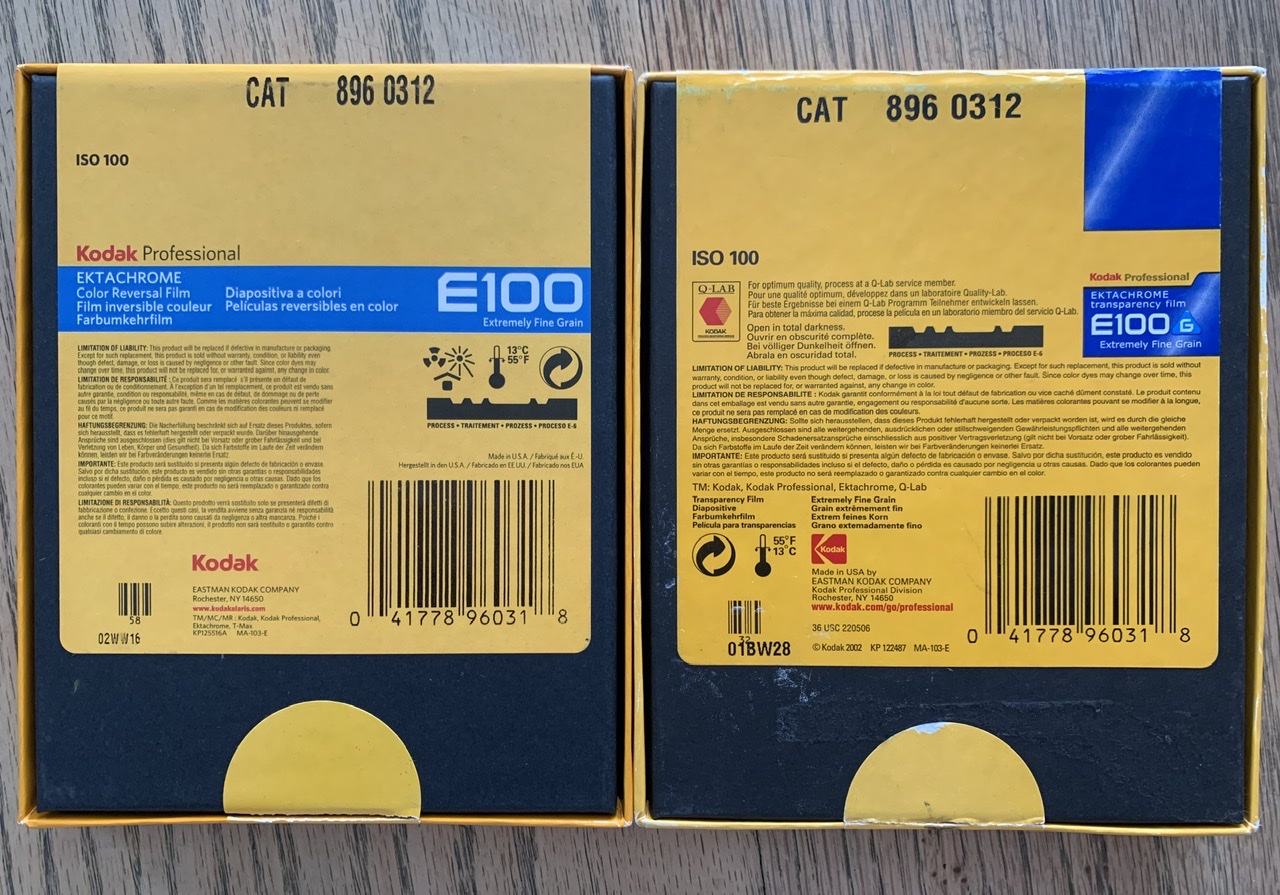

Hi everyone, I was shooting some of the new Kodak Ektachrome E100 film and I noticed the notch codes are the same as the old E100G
Is this the same emulsion makeup? Why change the designation and keep the same notch code? Was it just a mistake because the older technicians aren’t around to explain to new ones that notch codes should change with new versions of a film? It seems the bar codes are the same also.
Anyone know?

The two films are quite similar but not identical. Since E100G is fully discontinued, there's no harm done or confusion introduced by the newer film inheriting the same code notch. This kind of thing has occurred before.
Is this the same emulsion makeup?...
No, it had to be reformulated due to some E100G components sourced outside of Eastman Kodak no longer being available.
...Why change the designation and keep the same notch code?...It seems the bar codes are the same also...
Bean counters allocate a cost for every new SKU number. Since the old one is already in Kodak's "system," and associated with that notch code, re-using it keeps the cost of reintroducing Ektachrome lower. Marketing is simultaneously able to call it "E100" and thereby satisfy consumers' perpetual thirst for "new."

With respect to the 35mm film, there are a number of improvements built into the new version, but they are incremental in nature - the sort of improvements that one can expect every few years within an existing product.

A new SKU number costs next to nothing; the precise product name and label was changed anyway. I could generate a couple thousand new SKU's a day almost fully automated. Bean counters are easy to deal with if you have them take a long walk on a short pier; they rarely do anything useful above sea level. There is probably some minor set-up cost to any new code notch, but they avoided that nuisance task. In this case, deliberate product continuity rather than shock and awe seems to have been the priority. And since it's out of the gate 50% more expensive per shot than Fuji 4x5 chrome films, any r&d and marketing overhead would presumably be factored in. I don't shoot chrome film anymore, except for curiosity testing; but I would call this particular product very desirable despite the cost. I already considered E100G Kodak's best chrome film ever, and this seems even a tad better.
I'm young enough that I never shot the original before it was discontinued. I have shot this new one and quite like it. I wish it had just a tiny bit less contrast, but otherwise, it's pretty nice.

Generally speaking, chrome has high contrast, almost exclusively, I would say the closest to “low contrast” was Astia, a Fuji film that’s been discontinued for many years now.
Do you know the specific improvements? Just curious. I hope it scans better, the old stuff didn’t scan as well as Fuji chrome films from what I could find.
No, it had to be reformulated due to some E100G components sourced outside of Eastman Kodak no longer being available.Bean counters allocate a cost for every new SKU number. Since the old one is already in Kodak's "system," and associated with that notch code, re-using it keeps the cost of reintroducing Ektachrome lower. Marketing is simultaneously able to call it "E100" and thereby satisfy consumers' perpetual thirst for "new."
Thanks Sal, makes sense, especially if they still had the previous notch punches rather than having to re-tool.
