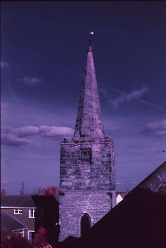

Here's one of my EIRs
It exhibits the same blue/purple cast as Ian's
