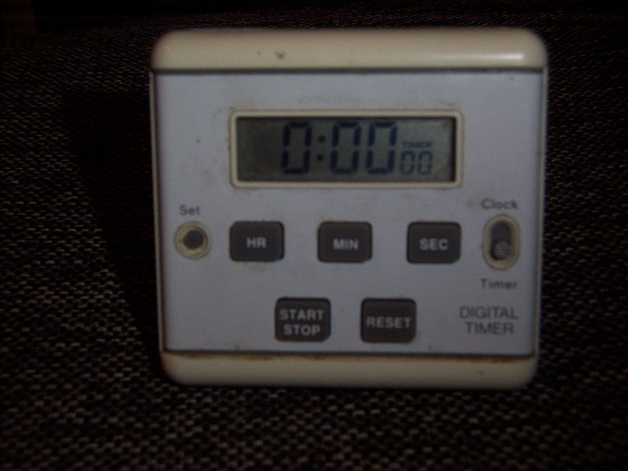

you could get one of these shimoda, it has a reapeating beep[ quite annoying] when time is up. And it projects no light, just a simple digital kitchen timer with a stand and magnetic back.Takes SR44 battery.
