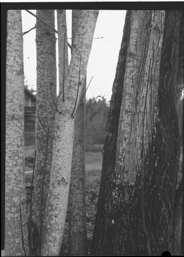

I use Fomapan 100 as my standard film in 9x12 cm. I'm very, very happy with it; it has excellent tones, nice fine grain, gives full speed in my process and a solid EI 160-200 in Diafine, and prints onto cyanotype well.
I haven't tried the Efke -- saw no reason to spend the money on a box, I like the cheaper Foma so well.

As is sit here looking at the original print of the picture referenced above I can see that they look nothing alike in terms of warmth and tonal value.
I'd really like to know how anyone can determine the qualities of a film from a web posted digital scan of either the print or negative. Between monitors, scanners editing software etc the number of variables are endless. The one thing that is certain is that the picture you see on your screen is not going to look the same on mine. I can understand looking at posted pictures from a artistic point of view. Trying to distinguish any significant technical detail about how the film itself looks is a waste of time.
Not knowing anything about how the film was exposed, developed and printed further makes this type of analysis useless. For all anyone knows the film was lousy, developed poorly and then saved in photoshop. Or perhaps the film was excellent and the photoshop stage manipulation made it look worse.
Bottom line, you can't tell much about the differences from a scan -- even true speed can be disguised by scan exposure/levels treatment, to some extent (especially making the scan appear to have less speed then the film). Grain can look better, because a coarse scan averages it away, or worse, because of artifacting. Tonality and range have more to do with scan settings than what's actually on the film, unless the film's range is terribly narrow or the scanner very poor.
Unfortunately, it's the only tool most of us have; I've never seen a physical print from Efke 100, and only a couple from Fomapan (my negatives, printed by a custom B&W printer as straight prints, hardly better than a negative scan). The few other B&W photographers I've had face-to-face contact with don't shoot these films; they shoot TMX or Plus-X.
Honestly, I'm not sure prints will really tell me much, either -- variations in film processing and printing will swamp the differences in the films just as surely as variations in scanning.
