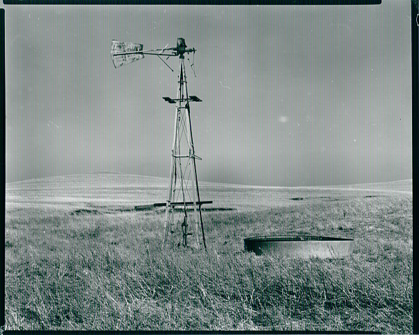

Worst Example I have Found
Here's a scan showing the subject problems. This is the worst one I have had. I cleaned and cleaned and cleaned, and could not get rid of these blemishes. They are in the emulsion itself.
All of the landscapes I have taken with PL100 show the vertical banding which is due to uneven emulsion coating. This is irregardless of development method. This example was developed with extreme minimal agitation but I see the same thing using brush or standard tray techniques.
Added the second scan; same place but entirely different camera and lens. The first scan was taken in March 2007, the second one taken in July 2007 and brush developed. Entirely different box of PL100. Same problems.

I've been shooting Pl 50 In 8x20 and It is a great film. No QC issues at all. I've been using Pl100 and I guess I must have been lucky because I haven't deen any banding problems at all. But I have recently seen the banding in Tmax 400 with 12x20 film.

Alex;
That problem you see is a classic one due to either an oscillating pump or an oscillating drive motor on the coating machine.
Other possible sources could be either variable pressure in the chill cabinet or a pressure fluctuation in the vacuum lines. These latter two are more dependant on machine configuration, but the first ones are universal to any type of coating machine.
It is easily detected on the master rolls by simple inspection. The larger the format, the more pronounced it can be. It can be nearly invisible on 35mm film.
PE
