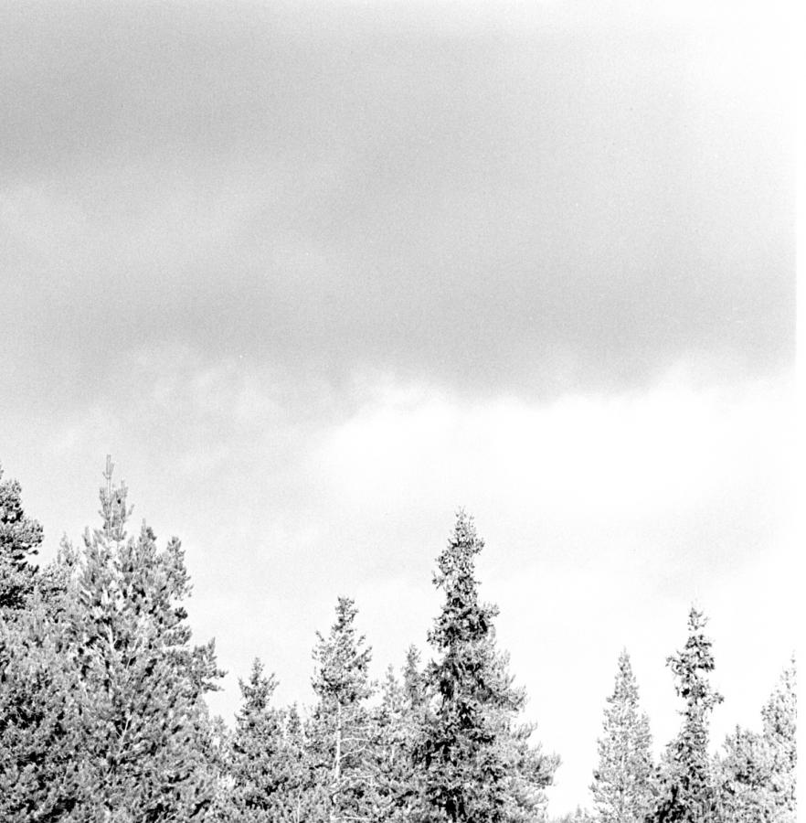

Just wanted a quick check with those of you that have use this film before. I have been searching for a cheap alternative to my regular Kodak sheet film in 8x10 and decided to try the Efke 100 - nothing has gone severely wrong with my limited testing so far but...
I wanted to check to see if this was "normal" for this film, It seems really really grainy - like grainier than TRI-X, etc, etc. I processed it in Pyrocat HD 1+1+100.
As long as your screen is about ~100 dpi this is about 40x (the larger version):
This is about 8x (the small version):
Just wondering what those of you more experienced with the Efke 100 think is up - if this is normal for this film in Pyrocat HD then I might just stick with my outrageously expensive Kodak.
RB

I've only been using Efke pl100 for a little over a year now. I am sure there are those out there with more experience with it. All the work I have done with PL100 is in Pyrocat HD at 1:1:100, at a careful 68f through out the process. Reticulation is a problem. I can confirm this with experience gained the hard way. To me your image looks about 'normal'. I attached a shot form my first shot with Efke. If I have all the settings right it should compare with your 1:8 example. Efke does have the look of 1970 vintage Plus-X (I have no first hand knowledge of film pre 70s :smile: ) This is to say pre dye layer and pre "T" grain films.
Thanks a lot - what did your reticulated 100 look like and how did it happen. All of my temps are 70 and always within 1 degree F.

To me it looked like shattered safety glass. ie distinct lines between the grains/clumps, and the clumps were big. I did it with a darkroom blunder. My first rinse water after the developer was too hot by far! I did not keep the neg (pl100 4x5) now I wish I had, but you could tell easily it was reticulation. In my case one could see it with the naked eye.
