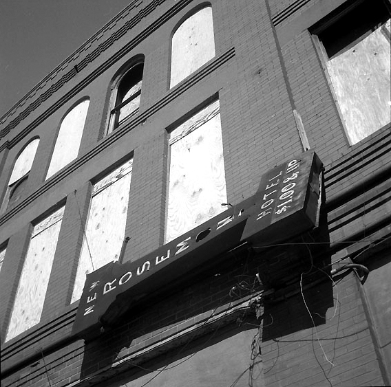

Here is Efke R100 in HC-110 1:50.
Rolleijoe
Dec 16, 2004
524
S.E. Texas
Efke R100 in HC-110
Oops, wrong button. Here it is, 1:50 for 6.5min, standard agitation. Rolleiflex 3.5E Planar.
