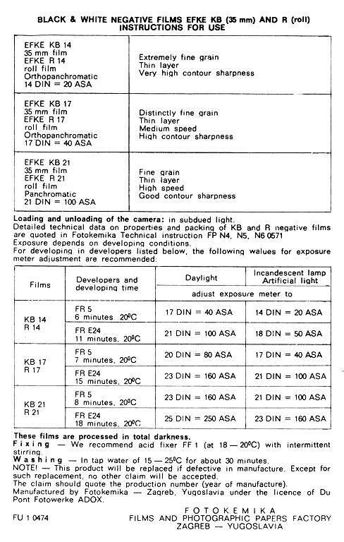

My old data sheet for EFKE films still with the DIN names is attached, but in practice KB/R/PL 25 have daylight EI of 40-50 EI, and a Tungsten speed of 20-25 EI.
I've used EFKE 25 since the 70's when it was called KB/R 14, my tests give me an effective EI of 50 for Normal use, and at one time a large UK chain of Photo-stores sold then as their house brand as 50 (KB25), 100 (KB50) & 200 (KB100) ISO films which makes sense.
