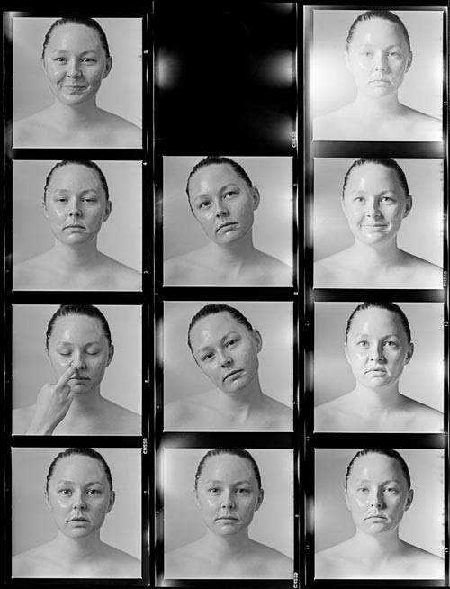

Here's an example of Efke R50 (or Adox CHS50) at EI 50, developed in Rodinal 1+200 (actually 3 ml Rodinal + 500 ml water) 20°C.
Agitation: Pour developer in, agitate about 10 sec, leave to stand. At 35 minutes, three inversions. At 70 minutes, three inversions. At 90 minutes, pour developer out, wash, fix, HCA, wash per my usual method.
I get strange marks on the left edge on the negs, but I think this is due to two things. First, my A12 doesn't put enough pressure on the film, so it's not flat against the mask. Second, the semi-stand development increases shadow detail, and therefore small light leaks, ie fogging, is exaggerated.
On the last frames, the effect is really extreme, and there is some yellowish stain (not visible in scan), maybe dichroic fog? I think this is due to the Paterson reels and the minimal agitation. I think I agitated so little that new developer did not reach the inner parts of the film.
Please feel free to suggest otherwise.
Negs aside, I'm quite satisfied with the pictures. I'm very new to using studio strobes eventhough I leared some of it in high school, and this is a mix of strobe and daylight.

Pretty sure your last frames are rolled onto the reel last, and the Efke/Adox films are horrible as far as light leaks go. They need to be loaded/unloaded in total darkness in my experience. That's the only reason I'm using Ilford and Kodak film instead.
- Thom
Looks like light leaks to me, not a developing problem. That, from what I can see in the scan.

The last frames on the film are top right in the attachment. As I transfer the film directly from the takeup-spool to the Paterson-reel, how can the last frames be rolled on last?
Yes I think they are too, but they are exaggerated by the semi-stand development. At least that's my theory, as I've never had such extreme light marks with Adox/Efke or Adox/Ilford before. :smile:
I`d like to add that you should do a one minute agaiation at the beginning. Only ten seconds can lead to uneven dvelopment..

Yes it can. But I was trying to see if I could get some nice edge effects, agitating that much would lessen these effects. At least that's what I read.
In conclusion, I can say that the pictures have OK shadow detail, and a certain lustre. I don't know if this is due to the efke film or my development of both. I can't say anyting about edge effects yet, though, as my scanner lacks the resolution. When I print them, I'll know.

one thing that bothers me a little is that you mention "yellow stains" in the last frames.
Are you sure your fixer is fresh and active?
did you wash enough ?
I've seen greenish-blue stains when I didin;t wash enough, some sulfite in the first water wash helped get rid of that.
With this efke films I've found that presoaking is excellent since it takes most of those ugly dyes away and prevents a few of thes eproblems

Hey now, I meant in the camera, so that when you unload the film from the camera those frames would be closest to the 'edge' of the spool, and therefore more susceptible to light leaks, especially if your camera does not roll the spool tightly.
In the developing tank, of course it would be opposite. All I'm saying is that you need to load the film in and out of your CAMERA in total darkness to be absolutely sure you don't get light leaks.
Hey, now I understand. :smile:
I agree that there are some light leaks. But what we're seeing on the last frames is also some kind of yellow stain (white in scan), that could be fog, or improper fixing. If it's badly fixed, I think it's due to the film getting stuck surface-to-surface on the reel, because the fixer is OK. I just did a roll in it, and it looks good.
Admittedly, I have some issues with this back/magazine, and I'm sending it to service soon. It's one of those backs with mismatched serials... I got it cheap though!

There is certainly more than one problem in this example but when fixing one after the other I would certainly start with the light seals of the magazine.
