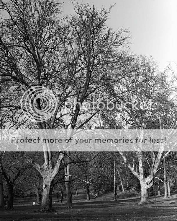

OK, now as I'm new this I haven't ventured into the whole printing side so I'll show a few scans to show the results.
1.

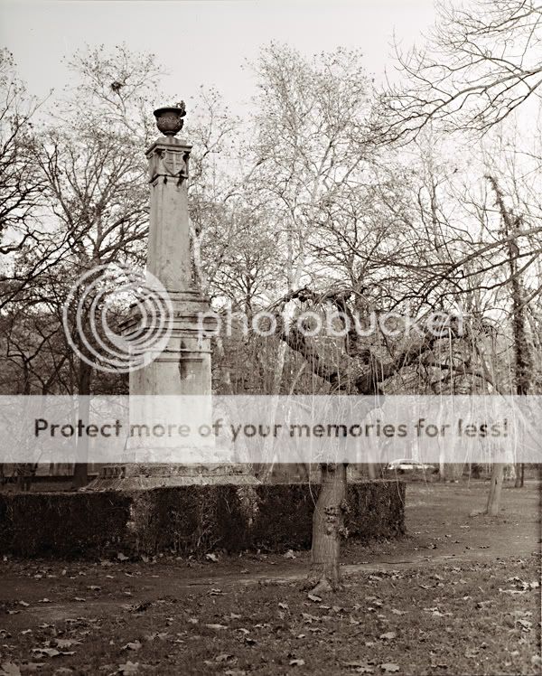

2.
Note: Image converted to Grayscale in PS which I didn't really intend which is why the colour of different to the other two images.

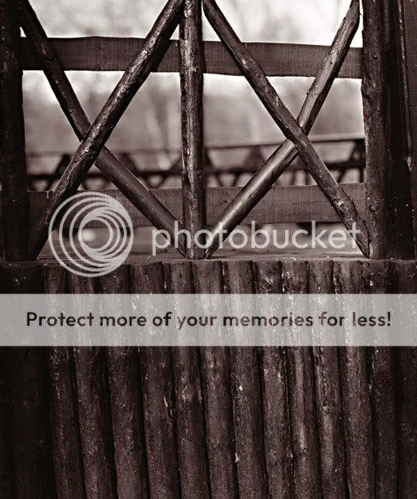

3.
Of course, I didn't notice the parked car until reviewing the negatives - c'est la vie!

Nice pics but I just note the technical side.
1.A light line can be seen in the sky at the edges of the cross bars.This is an edge effect typical of Efke/Rodinal stand development.
2.A long range of tones with detail in the shadows,the main characteristic of stand development.
3.Lucky to get no streaks with pure stand development.If streaks ever become a problem it has been suggested to agitate once every 10 min for 35mm or every 5 min for 120.
