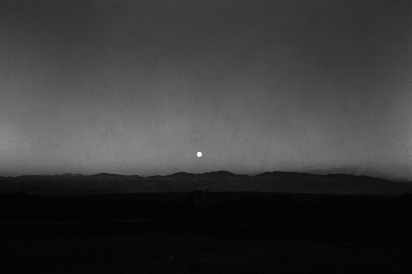

I too like this film. Here is something a little different than the other postings, Efke PL50 with a W25 filter to reduce the sky brightness in comparison with the Moon.
The image was made a few minutes after sunset as full Moon rose, with a baby Speedgraphic f/16, 3 sec. exposure. I made several exposures and this one was developed in DK-50, an old somewhat higher contrast developer that was long-favored by press photographers. The Efke film responds well to this too, as it does to the old standbys Rodinal and D-76.
