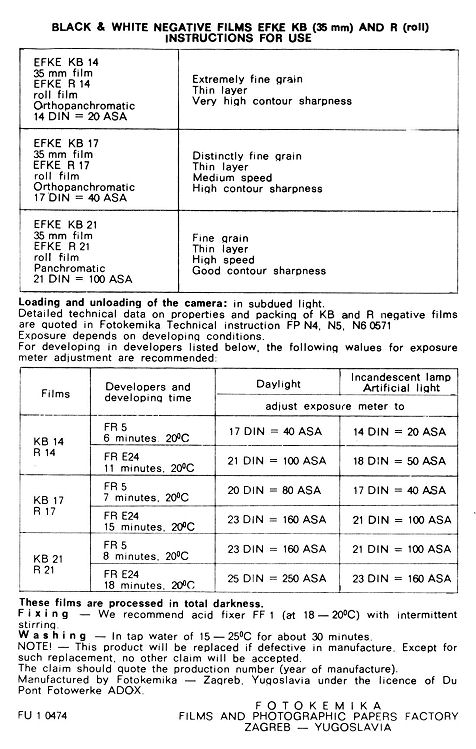

Not as bad as it sounds EFKE used to state a speed of 250 ISO in FR E24 (similar to Microphen) for KB/R/PL 21 - now called KB100 so you're only pushing slightly.
EFKE films are quite unique as they are faster than box speed in Daylight, but box speed in tungsten lighting. In the UK they were sold at twice EFKE's speed by a major chain as their own brand films.
See below
Ian
