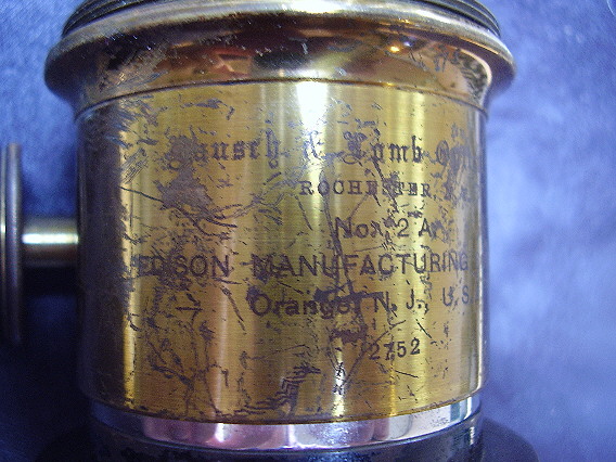

I have a lens that I've used infrequently and I've just put it on a 5x7 studio camera to try some portraits. It has, very faintly printed, on its side, "Edison Manufacturing, Orange, NJ" and then, lower, Bausch and Lomb. The only thing listed in the Vade Mecum is this:
"Edison" A brass and nickel projection Petzval type lens highlights the relation of Bausch & Lomb and the
Edison Manufacturing Co, for whom this is a No1 type lens. It is probably about 3.5-4.0in."
The brass and nickel projection part is right. Only problem is that this lens focuses on infinity at about 325mm and measures an f9 or 10 (WAG measuring system at work here.) My other Petzval lenses are quite rapid, more like f3.8
Any ideas?

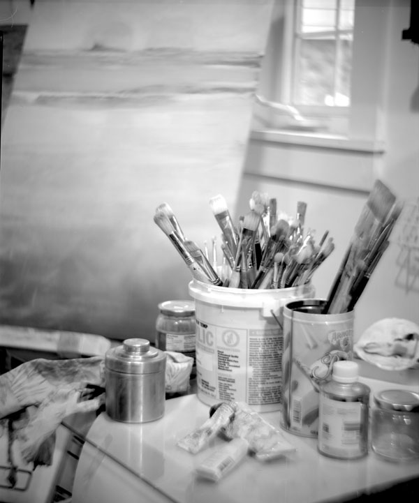

I've looked at all of the images I can find of the Kinetoscope, but never found a lens on one that looked like the one I have, which is, without posting a picture now since the lens is at school and I'm home, a pretty standard looking brass and nickel lens from the late 19th century. It doesn't have a slot for waterhouse stops, has a built in extension/shade on it's front end and is adjustable by means of a sliding collar and tangent drive. I bought it at a PHSNE auction a couple of years ago. I've attached one of the first 8x10 images I took last year with it. The picture made me want to try the lens for portraits, but I haven't gotten around to it.
The lens measures 105mm by 59.4 mm.

Does it look like this? This was a magic lantern lens I had for a while. 14 inch. I've found the lantern or projector lenses came in all sizes, and I've seen several with Edison written on them.

I have to admit it was a bit of a surprise, seeing one of my old posts resurrected this morning, and while I can't answer many of your questions with any finality, I can say that Bausch and Lomb did make lenses for Edison, as seen above in Goamule's post and in my own experience. I have taken a number of pictures now with that Edison lens (not scanned) and I like the "feel" of it. It is physically similar to the one pictured on the Kinetoscope, but then, so are most magic lantern lenses from that period. I found mine by dumb luck. Good luck in your own search and happy new year!
