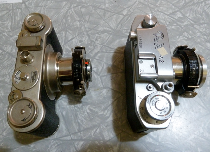

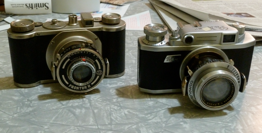

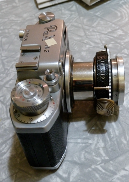

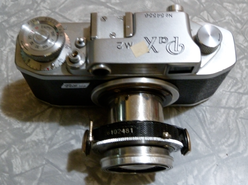

I found this rather odd combination (the one on the right) at a local thrift store decades ago. As you can see, it looks like a Leica, although smaller, but what's up with that lens?
It's actually a pretty good Retina/Xenon by Schneider, and f-2, no less. It has a front focusing lens element, and a compur-rapid shutter, so where did it come from?
From an Edinex. Mine (the one on the left) is a lower-end model, with a 2.8 Steinheil lens and Prontor II shutter, but McKeown's says they made a lot of variations, up-to and including compur shutters and faster lenses. So sometime or another someone took a Edinex and made themselves a Compur-Rapid "Leica," complete with collapsible lens. They did a very neat professional job, too.
A quick frosted-tape test shows the focus scale seems to be reasonably accurate. Haven't actually shot film in it, but I certainly could. The lens is clear, shutter is a champ at all speeds.
Sadly, the rangefinder in the Pax doesn't work any more, but that's a small price to pay for beauty.
