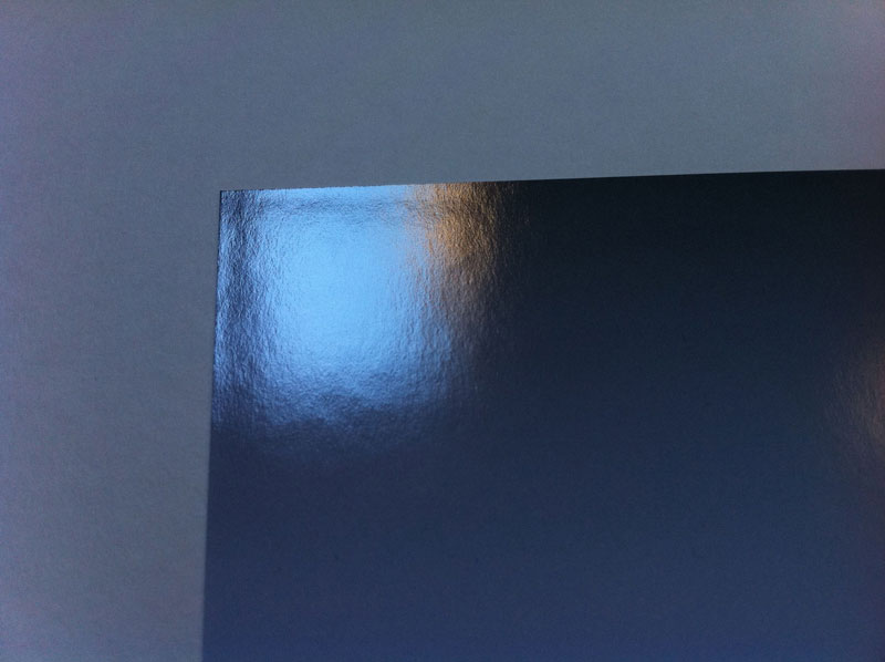

I have recently changed my mount board and I am noticing a dimple on my dry mounted prints. There is a very gentle, edge-long dimple parallel to all four edges of the print, less than 1 cm (1/4") from the edge. I can only see it when looking at the print at an angle at which I can see a light reflection along the edge, otherwise it is not visible at all.
The dimple is like a very shallow "valley" close to the edge of the print.
I am wondering if anyone has seen this before and if there was an easy solution, like higher temperature, more pressure, or the opposite. I use Unimount tissue (made in UK by Hotpress). I place the package under two sheets of larger 4-ply mount board and there is one such sheet under the print package. The press is a Bogen 560 (aka Technal).

My apologies, I should have provided more detail straight away. Please see the image, it shows the dimple in reflected skylight. The dimple is gentle and only visible in such lighting.

So this is new to me so I am willing to only venture a guess and suggest that changing a few things with your setup to see if the results might be different.
First, it looks (not trying to be too obvious here) as an edge effect. I wonder if changing the mount tissue would change this appearance of these lines. It may be due to the papers dimensional stability under the heat.

It is hard to tell the edge profile from your photo; but is there any possibility of the paper being overwashed? I had this happen once with RC paper that an employee processed. The edge of the paper absorbs water and swells permanently. Try mounting a scrap of paper cut from a processed sheet to test this.
This is a FB paper issue, nothing to do with over washing RC papers. It's exactly what I had happen when I switched to this particular company's tissue. Too hot/too long and it does this, it's getting the balance right.

I suppose I am late with the summary of how it worked out in the end. Well, I reached an impasse. I can either have no dimpling, but the prints will delaminate when I bend the mount board severely at corners, or they will have good adhesion at the price of some edge-long dimples. I think I made the dimples less visible, but I cannot get rid of them entirely. Looking just now at 28 mounted prints I can see that only 6 have almost no dimpling (the edges ever so slightly come up though), while 22 have dimpling. As I have been making notes on the times in the press for each of those, I can only see that what is common to all of the less dimpled prints is that they all (bar one) delaminated after an initial pressing and had to be returned to the press for extra time and overall they were pressed at a lower temperature for longer.
I have been cooling each print between two sheets of glass immediately after pressing for a minute or two, then cooling a little more between mountboards, and testing for adhesion by corner bending.
Maybe I am bending them too much?
I am, overall, at a loss to make sense out of the whole "experiment". I mounted some 40 prints in total. I started with lower temp (80-90˚C, 175-195F below the top protective mountboard, 100˚C, 215F at the platen) and longer times 3-3.5 min. This has led to less edge-long dimpling but far worse adhesion with frequent delaminations at corners, requiring a print to be returned once or twice back to the press. One print went back 3 times before it passed the "bending" test.
Then I decided to increase the temperature progressively at the platen to 121˚C (250F), which was giving temperature of about 90-100˚C (195-215F) under the top protective mountboard (4-ply all the time). Trying a sequence of progressively shorter times clearly failed to activate the Unimount Classic tissue evenly at 45 s pressing time. Time of 1 min 5 s seemed to do the trick, with prints adhering well or requiring one more trip to the press for another 1 min, when they always seemed to adhere. Unfortunately, the dimple was back, perhaps not looking quite like a "valley" but more like gently lifting edges.
I don't know what to try next, but I am keen to try a different tissue to see how it may improve things. I wonder if I can get any ColorMount in Europe, or perhaps I will try one of the HotPress's Archival Grade ones, they are reversible like Seal's BufferMount.
I have also tried other suggestions made here, that is pressing "upside down" with the print under the mount board, the press had been well prewarmed for over a day, and I have been using pre-dried boards and prints.

I owe you an answer how to solve the egde-long dimple problem, even though it has been more than a year since I started this thread.
As I have attended John Sexton's excellent The Expressive Black and White Print workshop (my experience: Dead Link Removed), a true gem was meeting his wife, Anne Larsen, who is a perfectionist when it comes to finishing prints, which includes dry-mounting, her primary technique of mounting. Her finish is faultless in every way...
Anne explained that the edge-long dimple was a problem affecting some papers, notably MGIV, which I use a lot. Perhaps it is to do with the very strong anti-curl features of this pleasantly stiff paper. Incidentally, I think the issue is also related to the size of the print, as at smaller (less than 12") sizes it happens less frequently. Anne's solution is to mount the print normally (see below for her approach), and then:
  • Let the press cool down to about 80?C (ca. 175?F),
  • Insert the already mounted print back into the press for a further 4 min or so, and apply full pressure.
Please note, that these instructions apply when using traditional tissues, such as Unimount or Colourmount, which adhere when hot. I am not sure, and I have not asked her, what would be the procedure with tissues that bond on cooling down, like Buffermount etc. As a philosophical aside, don't all tissues bond when they cool, difference being the temperature point?
All of this is in reference to a "normal" mounting procedure, which would be quite different for everyone, I suppose. So as a reference, this is what I observed as her approach, when mounting work using Colourmount tissue:
  • The press (usual, mechanical) is set to a very, very hard level of pressure. There was no way I could even half-close it with my hand between the plattens, when cold.
  • The bottom bed, which usually comprises foam over masonite, was used upside-down, with the foam below, acting as a spring, and the hard, masonite surface was on top, therefore under additional mount boards, which were placed under the mount board, that the print was being mounted to. I realise this contradicts the wisdom from the queen of mounting, Chris Paschke, as written in her handbook. But, it worked.
  • Operating temperature was 93? C (200? F).
  • There were two 4-ply (1.2 mm) boards under the print's own mat board, and so above the masonite.
  • There was only 1 sheet of regular 4-ply mount board above the print and under the platten.
  • She did not pre-dry mount boards (to my surprise, not sure if I could skip this step in Ireland's humid air).
  • Print was pre-dried (and flattened) for 40 s under full pressure.
  • Anne used a "cross" or X tacking pattern.
  • The time in the press was 4 min.
  • Out came perfection.
As a test, Anne recommended tearing a finished, mounted print, to see if the tissue adhered correctly to the print and the board. She did not feel there was a need to bend prints to check for corner adhesion, if you have tested the process a few times by tearing prints.
So, there you are. Now I need to try it all on my prints to see if I fix this recurring issue. By the way, there is every chance that I have written down my steps incorrectly, so please test, before relying... Any more feedback would be always very welcome.
