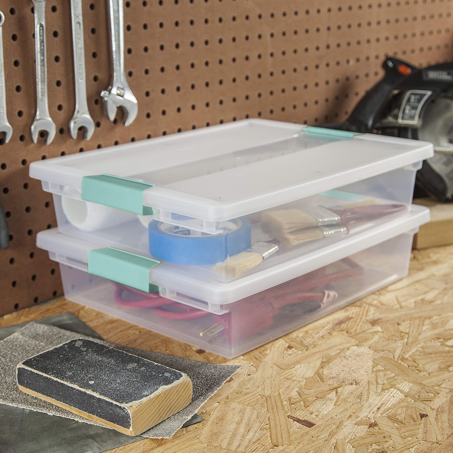

Too deep for me. I posted about the Sterilites that I have a few days ago. They cost a bit more but are not as deep and they have an elevated square on the bottom so its easy to pick up prints. I think these are them. I have regular photo trays, I only use these when I need extra trays for special processes or if I know I want to walk away for a few hours cuz lids.

Those are the ones I use. 9x11 inches fits comfortably in the bottom with room around the edges to agitate or lift... If you pop one of the "handles" off, it makes it easier to pour out of ( cover the resulting hole with a piece of tape on the outside to prevent drips ). The fairly sharp corners make them easy to pour out of without spilling -- into a bottle, or whatever. The plastic is hydrophobic, which makes them easier to clean thoroughly. There is also a size that is perfect for 5x7 inches and accommodates 5x8 okay. I'd like one that would fit 9x12 inches ( a common art paper size ) or 11x14.
IMO, those Sterilites in the first couple photos are too small for the print shown -- I recall a rule that there should be at least an inch all the way around the print, to avoid surge effects and local overdevelopment at the edges of the print.
