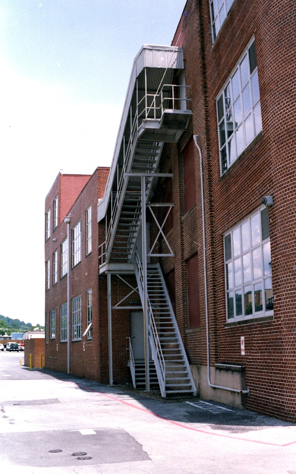

These images were taken on the Vision 320T film, with 85B filter, EI of 80 ISO, developed 5mins (106F) with ECN-2 developer adjusted for 5.4g/L CD3. Scans from negatives. I slightly adjusted the scans to alter contrast and brightness, as these things can be done in the darkroom. I may try a double development test tomorrow.
vision320T003ADJ_04.JPG vision320T006ADJ_03.JPG vision320T010ADJ_01.JPG vision320T014ADJ_02.JPG
