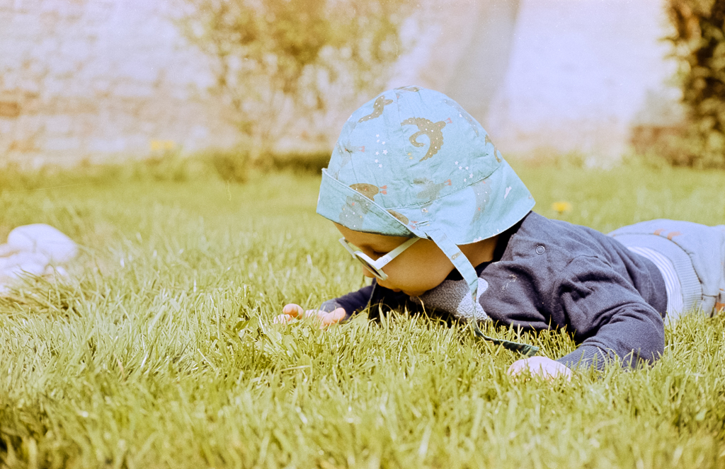

I recently developed my first batch of film with the Bellini ECN-2 1l kit and the resulting negatives all have a very strong color cast as you can see in these samples:
It's not possible to correct the white balance to obtain normal skin tones.
In total I developed 11 rolls of different film stocks (Vision3 50D; Vision3 250D) and shot on different camera's with both manual and automatic exposure and all have the same color cast.

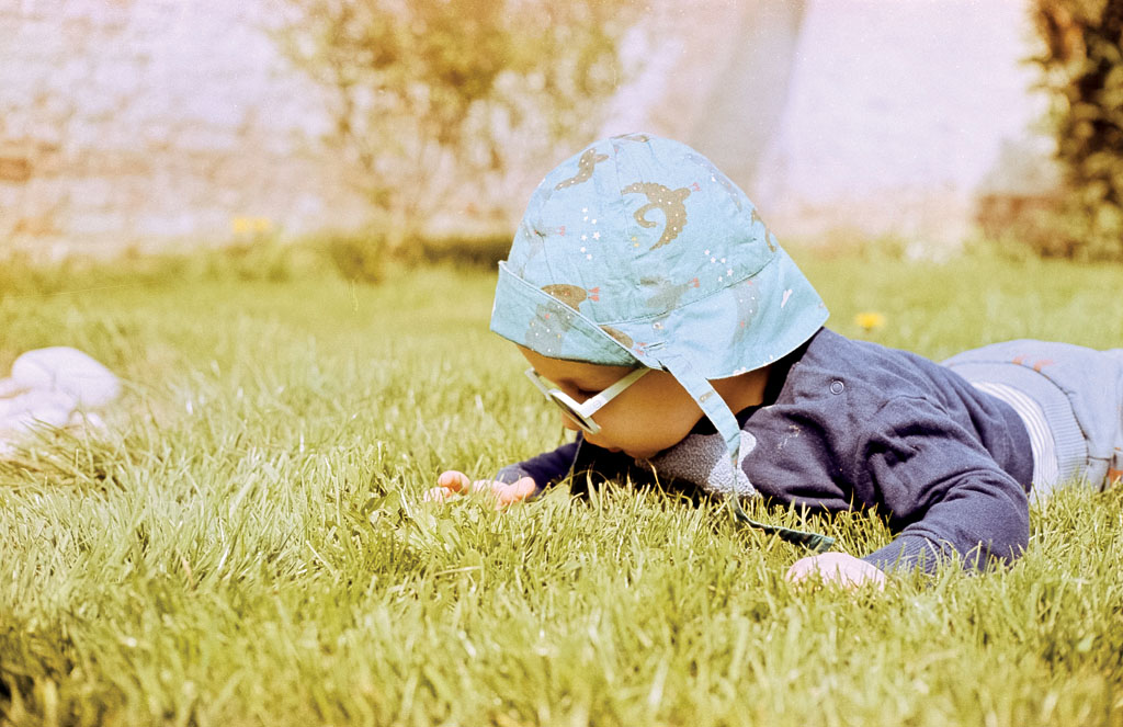

After tweaking the color balance I think they look pretty good.
View attachment 278089 View attachment 278090
I can make them look better in Lightroom but skin tones are never truly pink and vegetation is never really green.
I'm not saying I don't like the result but I believe Kodak Vision 3 should be able to render a neutral picture, and this effect should be by choice

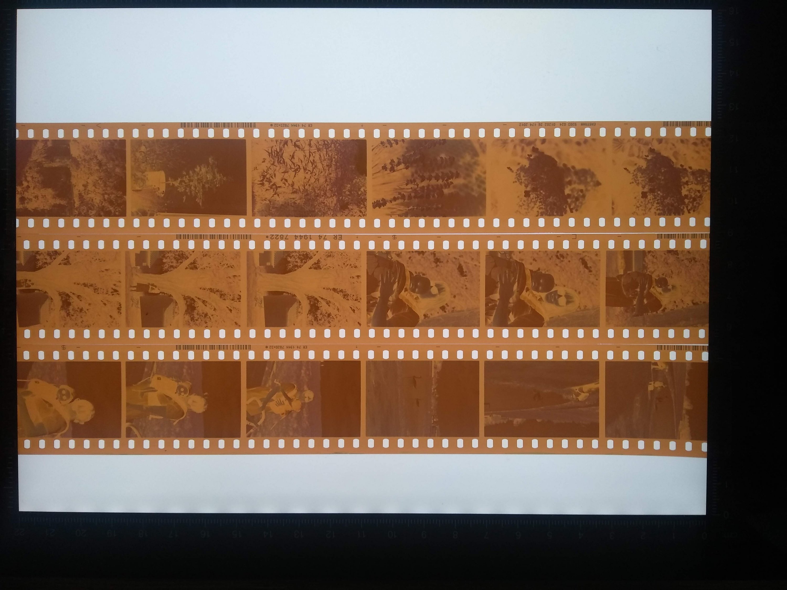

These are some of the negatives:
I scanned them with my Nikon Coolscan 4000, I never had these issues with C41.
I don't see anything obviously out of order here.
It might be that the scanner is a little confused by the ecn2 negs, since they are a bit flatter and can have a different colored orange mask. In my experience ecn2 negs are lower contrast and need more tweaking to produce good images than C41. But that is also how they were intended to be used.
I have no experience with the bellini kit, but I have noticed that mixed ECN2 developer goes bad very quickly. I usually use it within a week and then ditch it. However, concentrates seem to last a very long time.

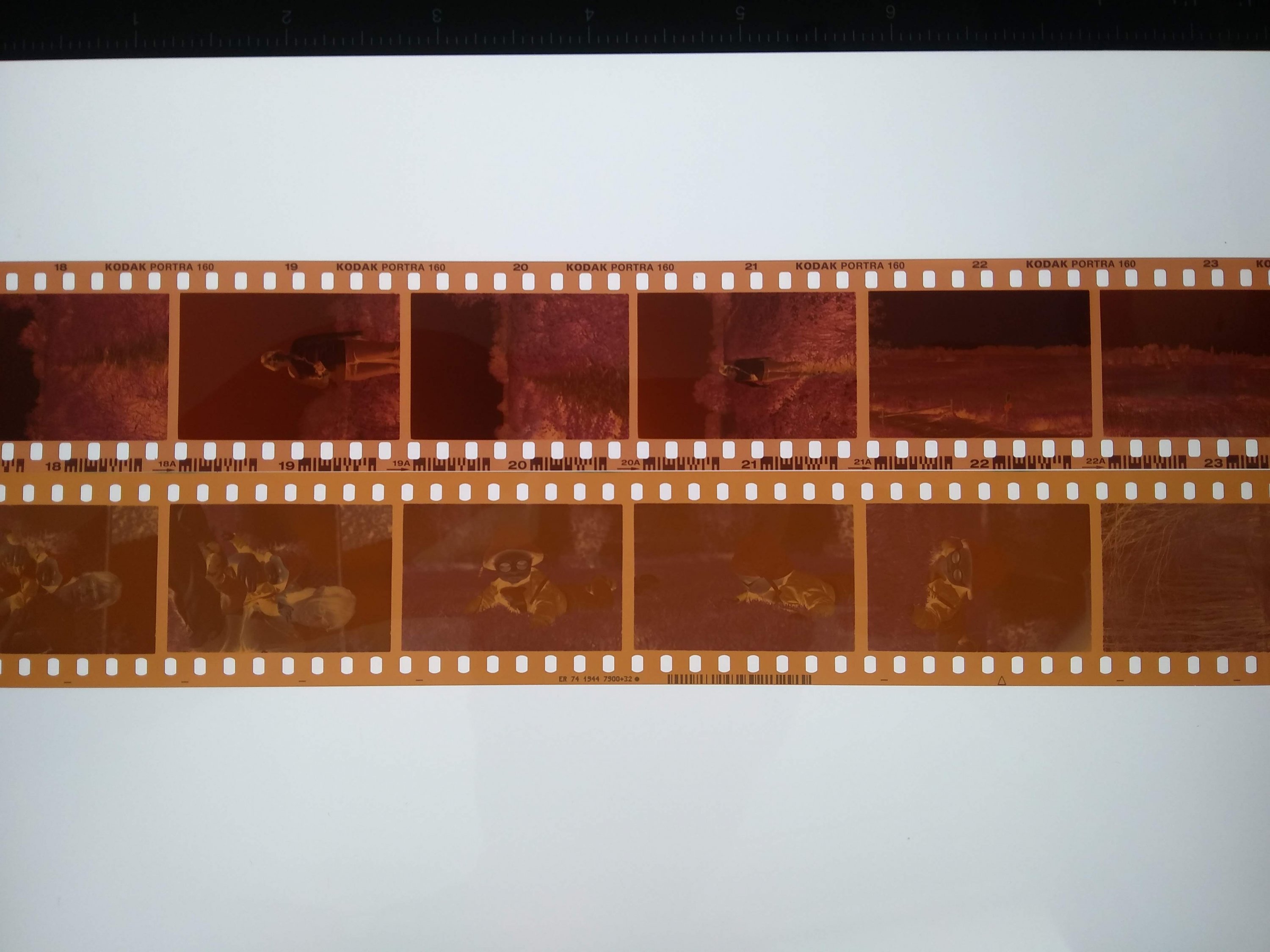

What about cyan dye? I can barely see any cyan in your negatives but could be just a wrong impression of your photo. Compare with good C41 negatives and if you can't see cyan dye or just a very low density where it should be (red colored things) then someting wrong happened with the chemistry, incomplete bleach being one of them.
ECN2 negatives are not equivalent to C41 negatives. The gamma is different and so is the color balance. Hence, crossover issues can occur if you process ECN2 negatives as if they were C41. Basically, all bets are off. Sometimes you get something fairly natural, sometimes you don't.

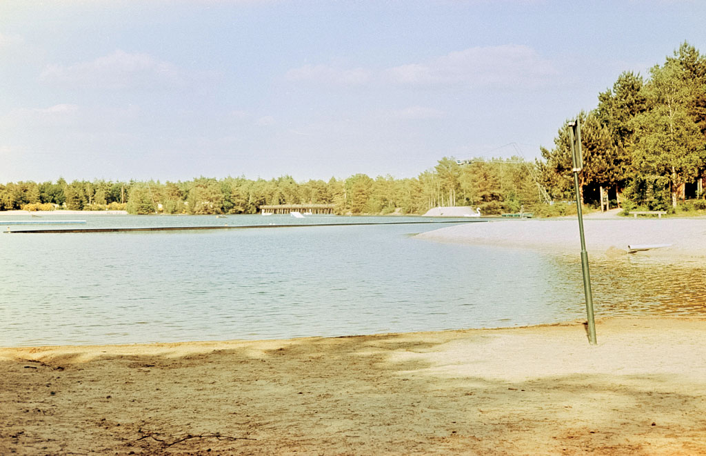

Actually what I'm noticing is that there's hardly any magenta in the negatives.
Which would be logical as the biggest issue is with the rendering of green.
For comparison here's the first scene shot with a DSLR:
Here a comparison between a C41 (top) and ECN-2 negative:
The lack of magenta is clear and the negative seems generally underdeveloped compared to the C41
So does this mean that the issue occurred during the development or something was wrong with the chemicals?

I agree that negatives seem underdeveloped, at least for C41 standards, but it is strange that you have no magenta dye. Green/Magenta layer is between the other two. You have some cyan dye, which is in the deepest layer, but no magenta dye which is in the layer just above cyan and more available to the developer.
