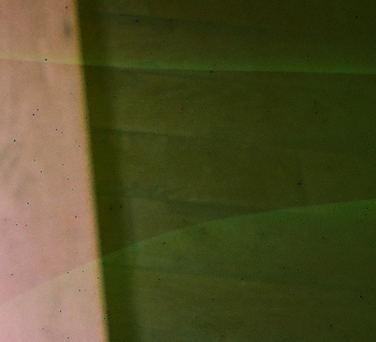

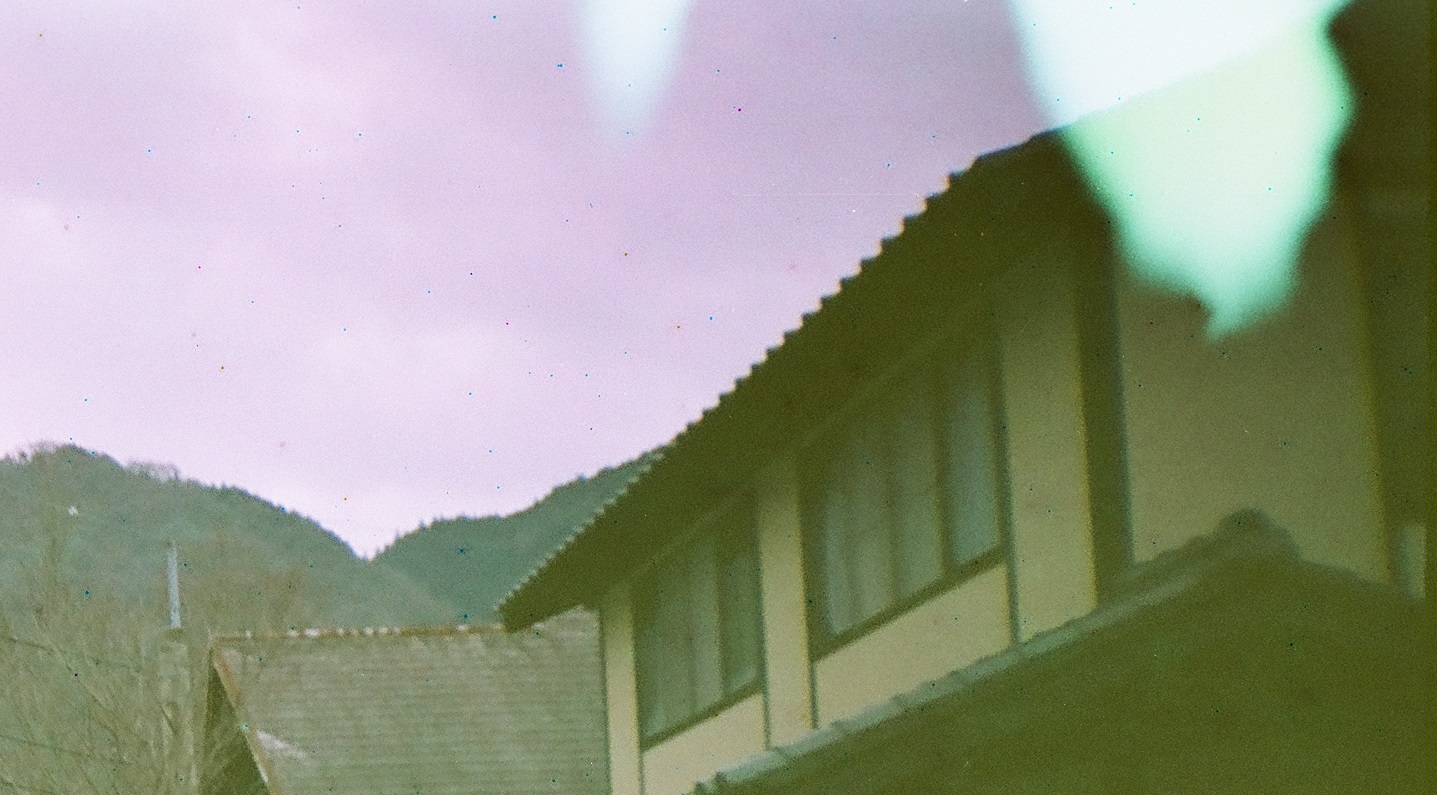

Hello. I'm using Kodak Flexicolor C-41RA chemicals to process ECN-2 films.
Before I pour C-41 developer, I finish the prebath step and remove the remjet as much as possible.
But I'm getting some issues that I never had before.
One is that there is some kind of Aura on the scanned images as follows,
I have no idea why this happens, Is it from uneven remjet residue on the film surface?

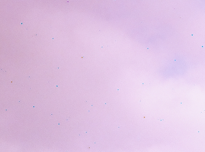

The other is that there are blue dots all over on the scanned images.
Also I have no idea why I'm getting them. I replenish every chemical after I finish processing each time.
Thank you.
That looks like a flow mark, possibly caused by too long a time between pouring in the chemistry and starting agitation. Want kind of setup are you using?
The spots are odd given their multi-colored appearance. Remjet remnants are possible though. I always used to wipe down ECN2 film immediately after processing with a soft cloth or tissue paper to get rid of the final bits of remjet. It never clears entirely in the prebath.

Do you mean dry mark, "green aura" on the scanned images?
Yes, that one. Check the shiny side of the film to see if there's a drying mark there. They usually have these bulbous shapes. I wouldn't expect them if the film has been wiped down though.
The picture is a bit small and I find it hard to guess what it looks like in context. Perhaps a somewhat larger image could help.

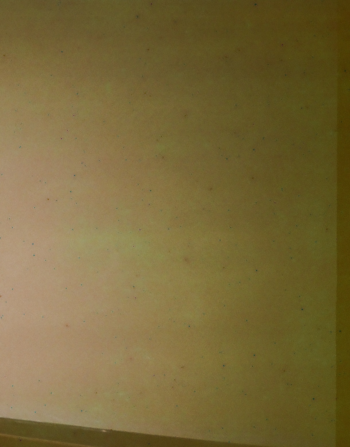

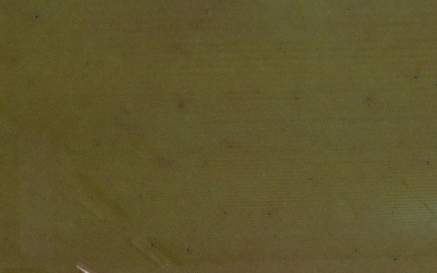

I attached more photos for your reference.

This looks like a major problem with chemistry coverage. Are you using a sufficient amount of chemistry for this tank?
Yes I pour 500ml for each chemicals for the process. I pour around 550ml for the developer just in case.

What are you using for prebath? I have found even using Kodak's lye based prebath, I still need a light wipedown in the final wash solution with a pecpad or fine sponge.
Those dots looking almost like a cyan dot is a bit concerning, remjet specs are usually solid white (black spec on the neg)

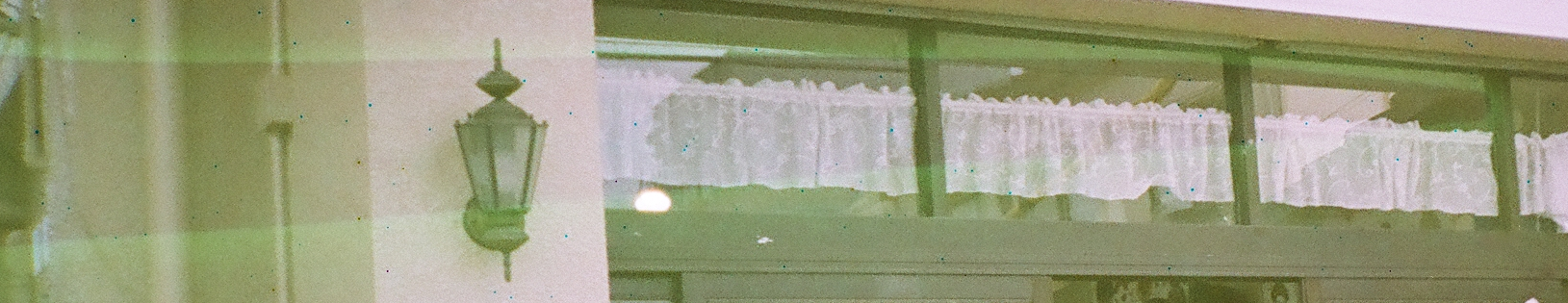

I don't think (but I'm no PhotoEngineer) those streaks are from drydown. It looks like some chemistry is interering with something.
