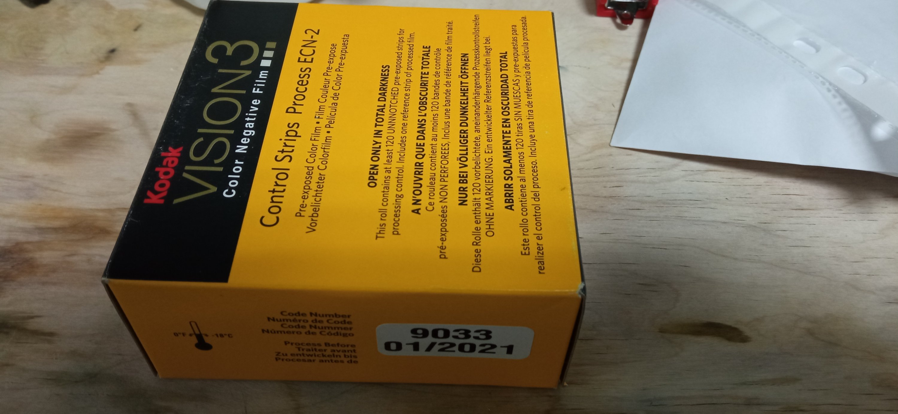

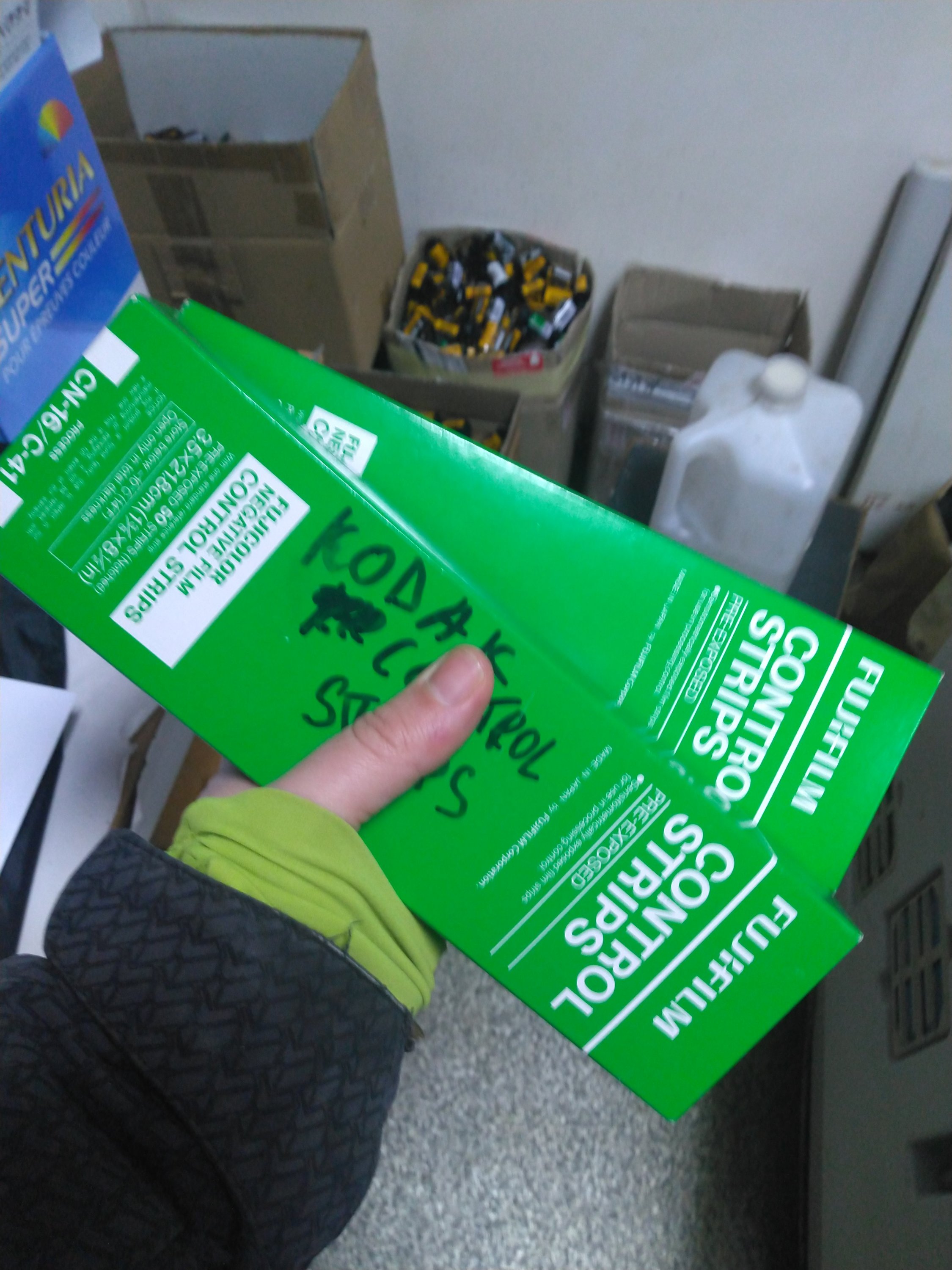

I have been waiting for these with a special order from BH Photo for a month, maybe.
It was my surprise to get them as a New Year present.. but outdated (due to 01.2021).
It was not and it is not mentioned on their web page that it is low-date or out-date.
:smile:
And for the most, I have been surprised to get this very helpful ctrl-c-ctrl-v feedback for my "whats-up?":
" I received the order on December 24, 2020 and on the box the expiration date is 01.2021.
This situation is unacceptable for a store with such a reputation as B&H . You must inform the client about such a late date.
Therefore, I have several questions.
May I buy a fresh Kodak Vision3 Color Negative Control Strips (BH #KOV3CS35100)?
Is there any way to get a discount on new purchase? "
" I'm really sorry about this. What I can suggest is to keep what's not being used in your fridge until needed as it extends the life. Once needed, take the film out of your fridge approximately 2 hours prior to use.
Please let us know if you require any further assistance.
Thank you, we appreciate your business. "
Am I too sensitive to feel like I was .. asked to go process it myself?
Or with this rare and almost unavailable type of Control-strip, I should be grateful BH ?
Sorry, if not the correct forum thread, please advise/move is so.

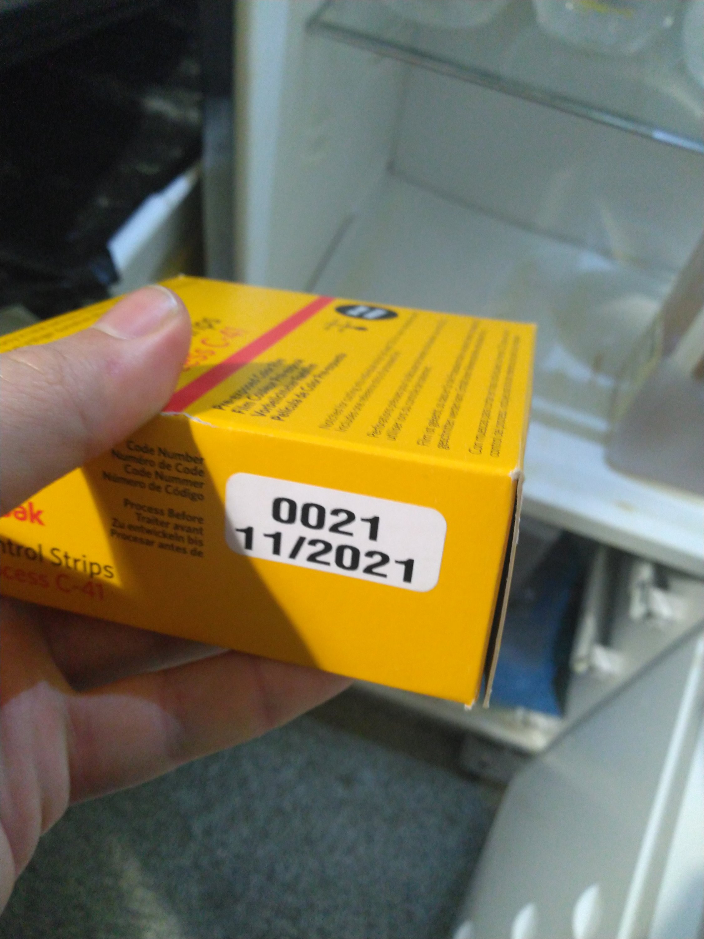

I received a box of Fuji C41 control strips two days ago and had the exact same happen. This is my very first box and an experiment trying to do replenishment with process control at home. My box says: Process before 2021.1. I ordered this domestically and I could have just called them about it. But I hate having to deal with things like that. It would be another wait and if there is no fresher product then only a refund... So I decided to keep it. I'm optimistic it won't make much or any difference.
More important than the date is that it has always been stored frozen until it was sent out. In the online shop this item has a delivery time of 4-6 days instead of the usual 1-3. That is why I assumed they'd order it fresh from Fuji and then send it out. But it was sent out on the second business day after my order already. So I'm not sure if it has been sitting around at the shop or at Fuji Germany.
Your box contains 120 control strips. Unless you are a commercial cine lab I guess it will take you a long time to use them and that makes it twice as troublesome. I understand your frustration! I expect shipping from Kiev into the EU is going to be troublesome (and might involve X-Ray treatment), otherwise I'd offer to buy a part of the roll from you. I do ECN-2 replenished, as well, and I'd love to get my hands on ECN-2 control strips.
That reply from B+H sounds like they don't really know what to do about it. That suggestion is what I'd recommend for an ordinary film, but not really for an expensive precision product like this.
Is there anyone here, who used to handle Kodak or Fuji control strips and remembers what their shelf life was, typically? Perhaps it is normal have only a month or so to use them up?

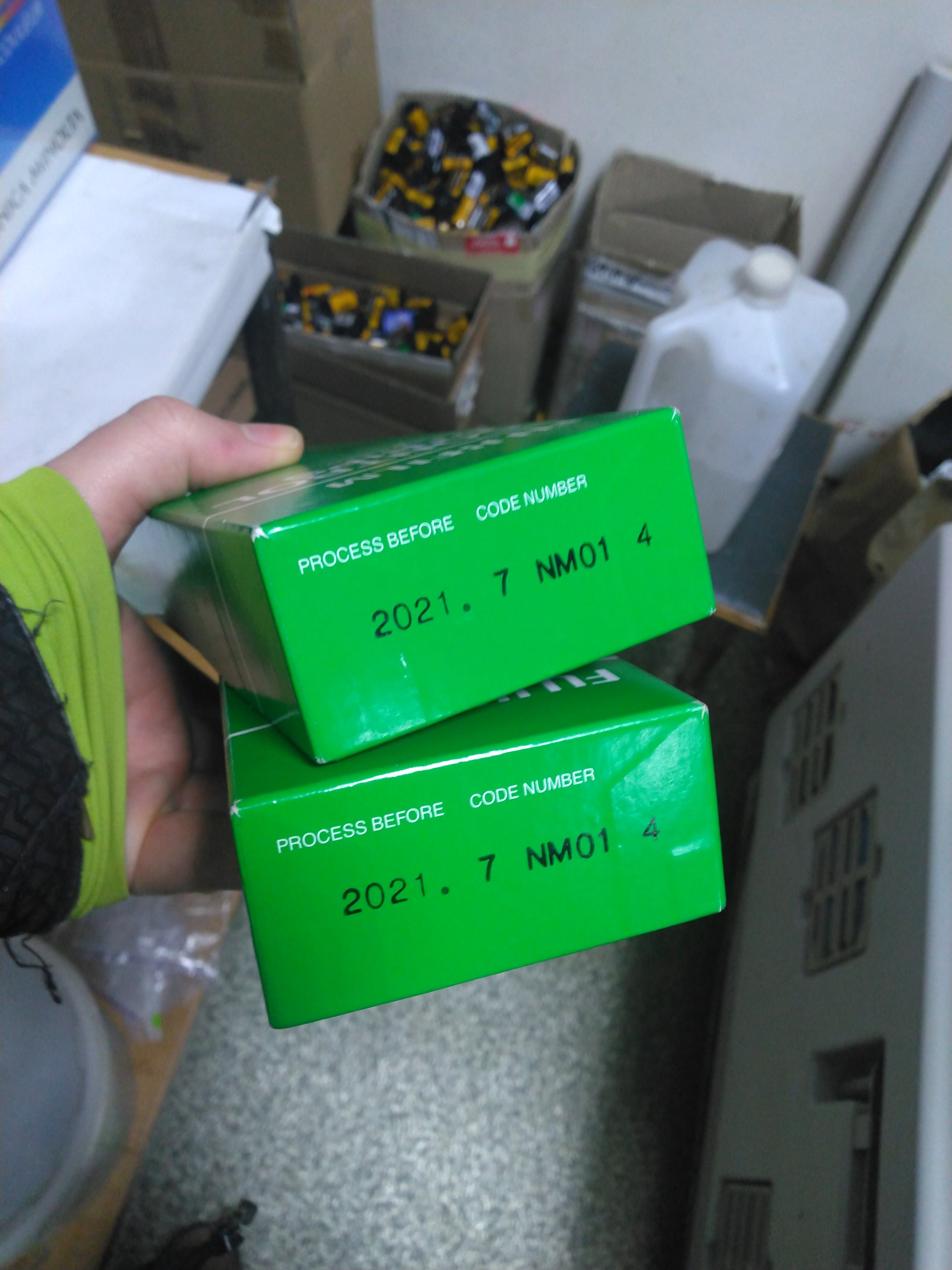

I think that Fuji makes control strips once a year in the beginning. Cause I bought maybe 4 packs already this year and they all were fresh for using "right now", but probably produced a 01.month. I need to recheck.
All of Fuji controls I got from BH and that is why I was actually LOL when opened a box of ECN strips on 01.2021. But I was mad getting that answer from bhpv.
Really, if a guy would even write me kidding that "we were trying to get in time with the present" or "sorry, we are in the same position dependent on our supplier..." or whatever human being could write to human being.
But they used this ctrl+c / ctrl+v approach (ignoring to reply by subj) and that is max insulting.
I am not so optimistic about people. I would suppose that things are mostly not good about storage so the best chance is to keep things rolling.
Manufacture storage I think is OK as these guys bear final user quality complaints.
So ideal situation for me (you also write about that) is this frozen box ride to the resaler and asap reshipped to the user.
With bhpv before this time, I worked like this - Fuji c41 controls were sometimes on stock, sometimes on the way or preorder.

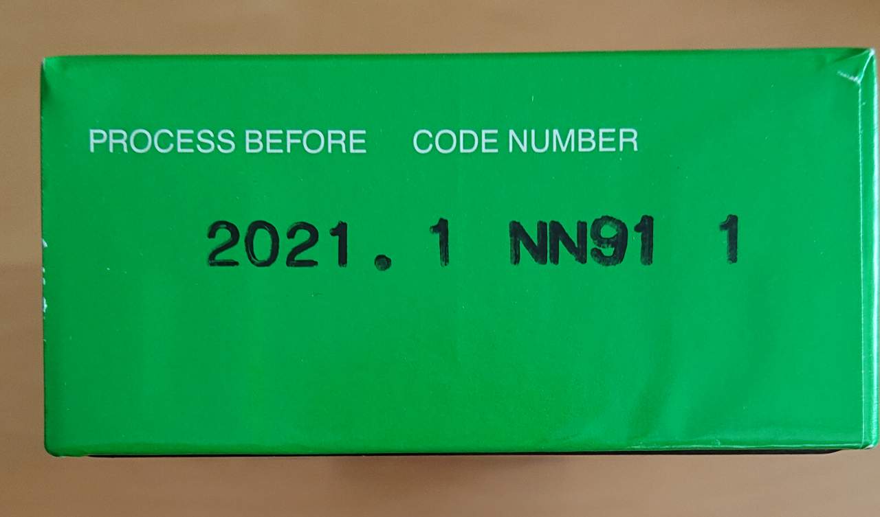

Reply from bhpv sounds like they are fine and eat well, no need to worry. :smile:
As I recall it is 1 year for Fuji. Don't they write that on the box?
I have the same problem ordering Fuji Strips domestically through Fuji dealer. So I did that thought bhpv as decided that their turnover may grant hope for the fresh stock.
From our experience, Fuj strips bought over the year are about 0.02 D stable and that is actually the precision of our xite810.
I think it might work well for you frozen from the point of replenishment control.
I just realised that I already had the answer to my own question. I saw a notice from Fuji that something changed about their Control strips. Basically the new version doesn't have the Fujifilm logo at the top. The notice says that the new type is being delivered from April 2020 starting with Code NT01. My reference strip still has the logo and code number is NN91. At least 8 months old, and probably a year.
A long time ago I bought some short dated, discounted Velvia from that shop and in their descriptions they said that they store their stock professionally (temperature wise) and hence the short dated stuff is reliable. If they are trustworthy I'll expect them to store control strips as required by the manufacturer, otherwise to order on demand.
Here is the date and serial code from the box.

Made pictures today of some empty boxes with Fuji and actual Kodak c41 strips. Our Fuji from midyear was NM01 and two more are deep in the freezer so I couldn't dig them out.
Could you please send in PM or link here about Fuji notes?
I also rechecked Kodak c41 present strips. I think that they do not mistake at this point and put the process before in the right place.
Fuji strips that we have reference and aim values offset inside each box.
Each box has these aim values correction factors paper inside and each looks like one on the image = absolutely zero offsets.
I was used to the fact that if you add a document with a correction/filter pack/offsets inside every box it must be relevant for this exact box.
First I was thinking that Fuji came to the point of such a quality that could make strips of ideal quality (zero offsets).
But with practice, I came to fact that I is not possible to get the process into their reference strip with 00 correction factors. No way I tried.
Either you have lower HD-LD or too high Dmin. Also, one channel (red if I am right) always 0.04D lower than B and G.
We were fighting with this issue for a long time. But If you UP replenishment rate to keep up with the lowest limit of HD-LD let's say - 0.05/0.07D you hit Dmin upper limit and pH showing you are out of +0.05 to normal (each manufacturer uses different normal from 10.01 to 10.07) and the sensitometer strip shows you are under contract index over 0.61. But fuji strips a low... :smile: We tried to change the chemistry brand: Locally.made 23 and 45 to ->Kodak LORR to-> TetenalSP45 to finally -> Fuji Hunt C41 RA. We tried to change the pump in the machine thinking that it was possible under-circulation and even changed the machine. We couldn't cope with Fuji HD_LD vs Dmin. Even Fuji chemistry in the fuji processor showed the same -0.04D R channel HDLD under the other 2 channels. So it looked like ...
We ordered Kodak C41 controls (need to say that c41 controls were not so readily previous years before this boom with film came 2 years ago) when we saw that they were available just at bhpv.
Kodak corrections you could also see on the picture. They are way away from zero-zero. And they showed overdevelopment and ok Dmin in all chemistries.
We even had 2 machines running at the same time: one with Fuji c41 and one with Kodak c41. And cross-testing both with Fuji and Kodal control strips. Fuji showing under development about -0.07 in 2 channels and -0.11 in another (with Dmin already about the top of +0.04 to 0.05) and Kodak over-development about the same +0.07 to + 0.09 to HD-LD aim (what was fun that with Dmin about the ideal +0.01 in all channels).
So from all that information, I came to the idea that Fuji put zero correction not saying all the true about their emulsion (maybe if you use their Oasis service they would compare to the real emulsion data).
