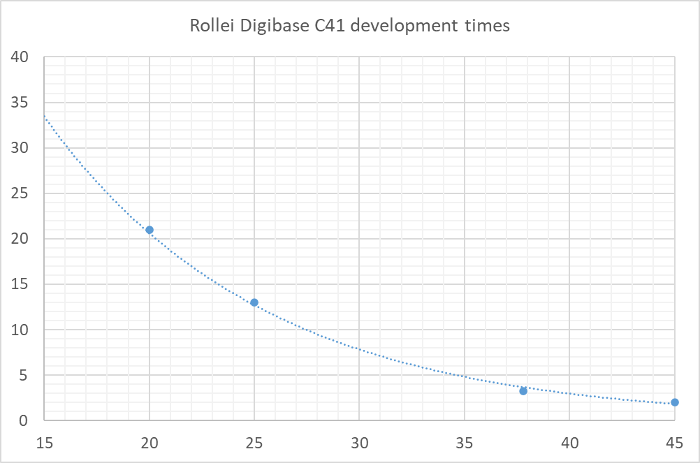

Nope, but no doubt it'll work OK. Just give it a go and perhaps use the temperature compensation of Rollei Digibase C41 as a starting point. I once made a curve based on their development times for a few temperatures (see Rollei instructions):
The dots are the times I took from the Digibase instructions. The curve is an exponential curve that shows a pretty good fit for these times. At some point I had this chart taped to a wall in my darkroom.
