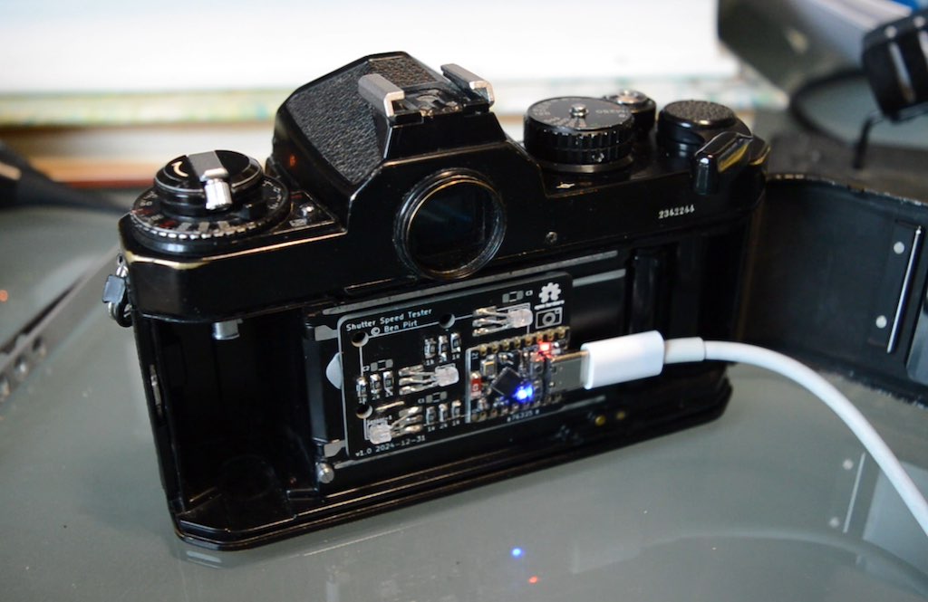

Hi folks, thought you might be interested in this three point shutter tester I recently developed. It's very cheap to build and uses Bluetooth to communicate the measurements to a web page that can do nice things like show averages and how far off the shutter is from being accurate.
It's all open hardware (and software) and the repository is here: https://github.com/bjpirt/shutter-tester
It uses the ESP32 as a microcontroller and so can make use of Bluetooth for communication. I've written a web app that uses Web Bluetooth built into Chrome to take the readings from the sensors and collate them all into a table so you can make averages and get a report of the calibration of all the speeds.
You can check out how this works on this demo video I put together:

Welcome aboard @bjpirt and congratulations on this very interesting project! I like the elegance of the mechanical-electrical solution, requiring no additional housing etc. I hope you'll stick around on the forum to answer any questions that members will undoubtedly have.

Thanks - I've been a long time lurker on the forum so will definitely be sticking around. I'm a big believer in the open source approach to things like this and that only works if they're not abandon-ware so if anyone has any questions (or has lots of cameras and wants to test it out!) fire away!

Great, I'm very interested in learning more!
I'll start with probably the simplest question 😌
How do you attach the sensor to the film window?
I actually just use a couple of small pieces of Blu-Tak - it sticks well and isn't too close to the shutter. However if that makes you nervous you could use an elastic band or some masking tape.
Is it possible to buy a finished device or have it assembled?
Not at the moment, but if there's enough interest I might make a small batch

What's it's accuracy and how have you verified it?
The sensors itself have a delay of 0.1-5us or so, depending on how they're implemented. Let's say single-digit delays.
The sensor readouts are interrupt-driven; typical inaccuracies in those ISRs (interrupt service routines) is in the order of the low-single microseconds.
Add to this the inaccuracy of a typical crystal that's used to time the ESP32 - this will be 40ppm or so, worst case.
So let's say this adds up to 10us, which is a particularly dark scenario. A 1/8000s shutter speed = 125us, so the timing on that one might be off by 8%, which is less than 1/3 of a stop. Again, that's very much a worst-case scenario.
I've compared the timing against a Salae logic analyser and the Arduino was within a microsecond or so of that timing which I was pretty happy with. I haven't yet added compensation for the sensor width which will have more of an impact when measuring faster shutter speeds but I will be adding this shortly.

Getting these things [focal plane shutter testers] to detect errors in shutters at 1/1000, 1/2000, 1/4000, and 1/8000 can be tricky. Little changes in the alighment of the sensors, the holes and the light source can have big effects.
All of little relevance.
The accuracy will depend much more on how it detects the curtains, width of sensors, angle of light source etc. etc. and not on the component tolerances.
So you don't know how accurate (or inaccurate) it is when measuring real shutters then.
I want to compare it against a known good tester - if anyone is able to help out with this I can send them one to play around with. If you have any suggestions on good ways of checking accuracy I'd be keen to hear them
Minolta, for example, specified a tolerance of 0.5 EV for the exposure metering system of its 7000 AF. This is completely sufficient for practical work.
And from what I understand from your explanations, this is true.
So do the same analysis for those factors for a realistically pessimistic scenario and tell us the outcome.
It's easy to be critical of someone's work; contributing constructively is more challenging, but a lot more interesting.
In product development, verification should be a planned exercise. I think you have a way to go yet.

It's the guy who designed it and is trying to sell it to prove it works
Not trying to sell anything - it's all open source and I have a day job. I was just hoping to engage the community here in creating something useful for everyone to use.
