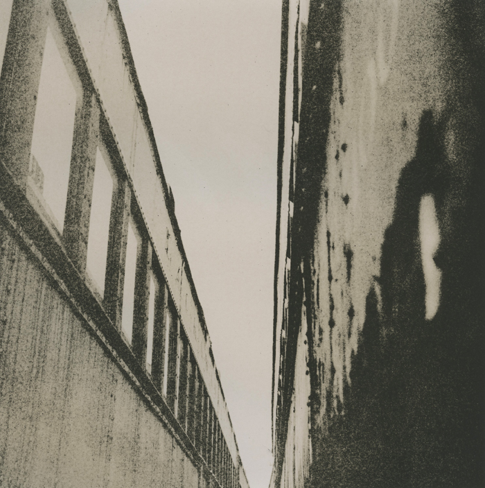

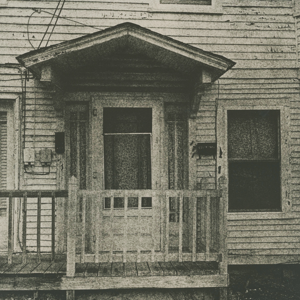

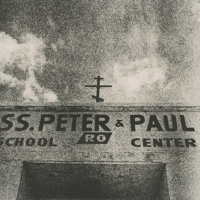

So here is the update. I remixed A+B and I am attaching the results. At least I got something this time. The last print of the train the developing time was way to long. Also compare to some sample images on the Moersch site mine are on the grainy side. I don't mind it but I am looking forward to my next bottles and new dilution variations. Is the lith suppose to be exhausted fairly fast once on the tray?
Anyway tell me what you think and thanks in advance.
PS. Colors is a bit flat and off due to scan.

The grain is probably inherent in the paper you are using I use the fiber version of that paper and it is grainy like this. The development times are also longer than any other paper. If you want close to neutral and a little less grain, try Slavich. If you want considerably less grain and more color, try Fomatone. These are the 3 papers I use almost exclusively for lith (except for the Kentmere Warmtone I have stashed away....)
Thanks Mark. I would try it. I believe I have one sheet of Fomatone left. I know the Arista EDU is grainy but haven't use the paper for a while but it makes sense. Any idea how ADOX is? I have some of that and will try as well.
Cheers.
n.
Cheers.
n.
My experience with the Adox MCC paper is that it is more difficult to lith print. I'd advise you to work with the Fomatone papers first until you get good at it and then try other papers.
