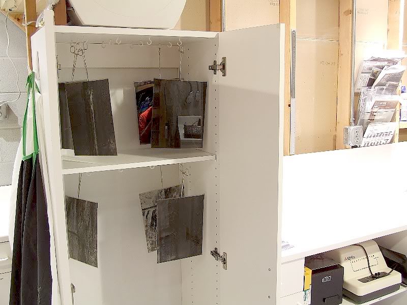

I got an easy-to-assemble clothes cabinet at Home Depot back in 2001. It has worked great ever since. No heater or fan. They stay over night and are dry in the morning.
The shelf comes out and rollfilm can hang.

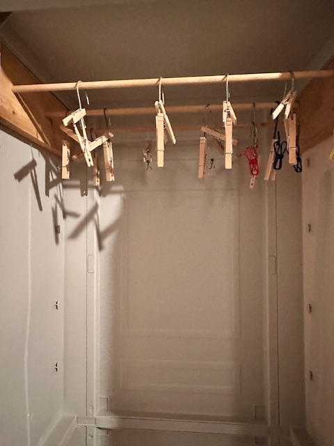

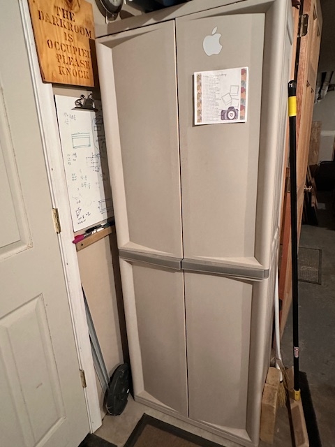

I used an outdoor tool storage cabinet from Lowes or Home Depot. I drilled some 1x6's into the side to support dowels to hold the film. Works great, no heat, no forced air, just timed drying over night. no dust.
