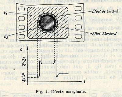

By reversible process is understood that the resulting image is accordance with the subject.
Where white is white result in film.
Where black is black result in film.
I thought to marginal effects in processing.
The marginal effects (of the adjacency), which are presented in Figure 4 the effect of the bead, the effect EberJiard represents unevenness of density that forms the boundary of separation of areas with different exposure, due to anomalies in the conduct diffusion of substances that occur within the emulsion in during development.
George
