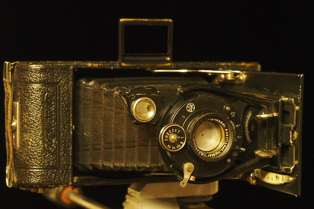

My Zeiss Ikon Nettar was very easy to convert. The lens came out easily and the shutter has a T setting which is much more useful than B.
