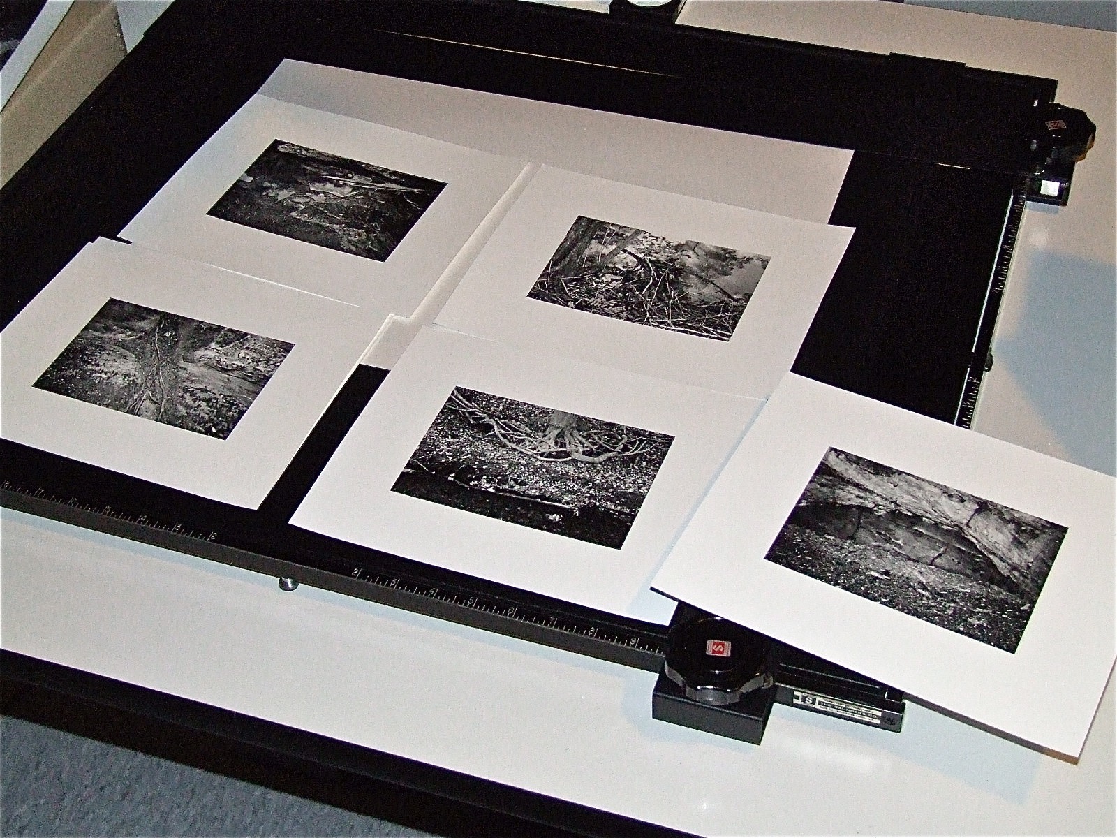

ic-racer
Feb 25, 2007
16,485
USA
At the moment, i am interested in knowing the (round numbers) math for "preserving" the 35mm negative ratio onto 8x10 paper.
Thank You.
It doesn't fit with an even border. The ratio of the length of the sides of the rectangles are different.
The magnification ratio I use is about 5x for 8x10 paper.

CMoore
Aug 23, 2015
6,191
USA CA
What do you mean by "even border".?
See the easel in your picture.?
When you enlarge a 35mm negative, is your ratio close to the same as the negative.?
What numbers are your easel blades set at.?
