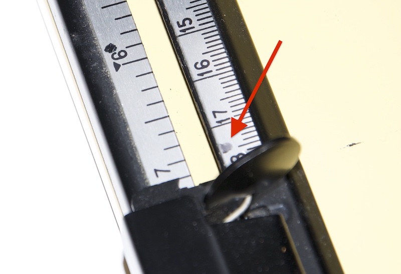

I ignore the number scale and put some dots at the appropriate place with a permanent marker back in 1974 and, those marks are still there!
