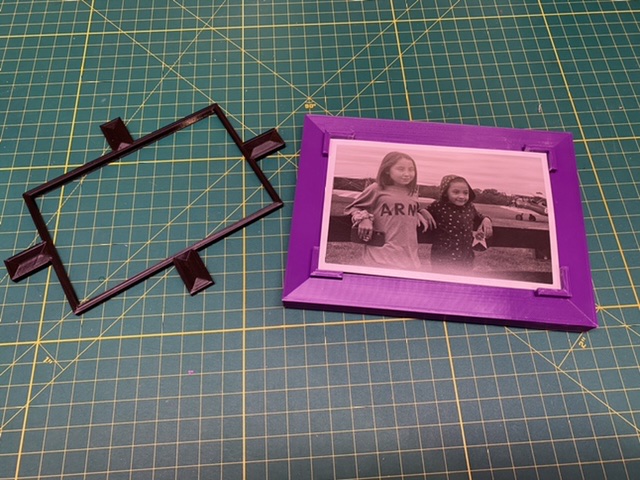

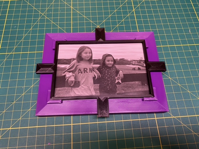

A new post to an old thread, but I have STL files for a 3D printed easel for this paper. Send me a DM if you’re interested in them.
View attachment 244193 View attachment 244192
Looks like a good product . Clearly 3D is the way forward and will be for a lot of darkroom stuff that is now unobtainable, if indeed some of it ever existed. People had to "make do and mend" back then
If I didn't have a home-made easel which meets my needs and I lived in the U.S. I'd certainly be contacting you. Good luck with sales
pentaxuser
Hello Pentaxuser,
Thank you for your kind comments. I'm not selling anything. Send me a private message with your email and I will send you the files. You just need to provide a printer.
Thanks
