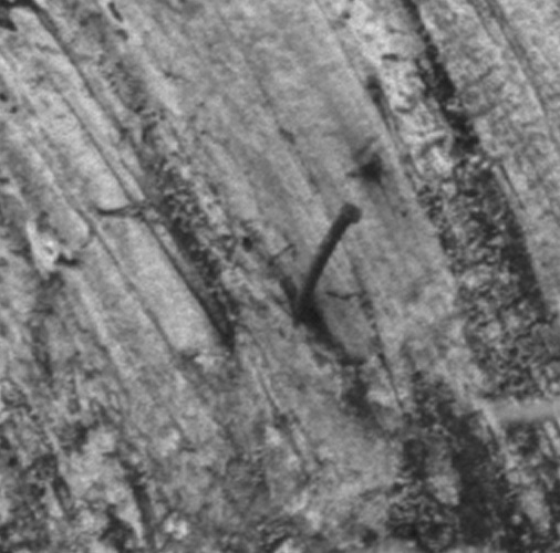

Attached is a 6x6 mm crop from a 9x12 cm negative shot when testing my Ideal after repairing a detached bellows. This is about 1/3 the negative area of a Minolta 16 negative, shot through a lens like the one you have; Fomapan 100, EI 160, developed in Diafine. Go make good pictures... :smile:

that's a great amount of details your lenses give, though the glass is not perfect... it really stands in line with modern lenses! :smile: Today I shoot two sheets of Fomapan 100 with the lens, on 5.6 it's okay, and on f/18 I can see sparks of sharpness :smile: And the bokeh is just perfect - alas, can't scan and post my results, I didn't get the LF scanner yet :sad: But the lens costed $15 to me, together with crappy Kraft plate camera :smile:
