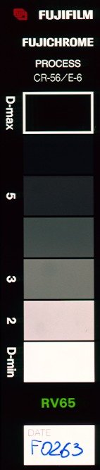

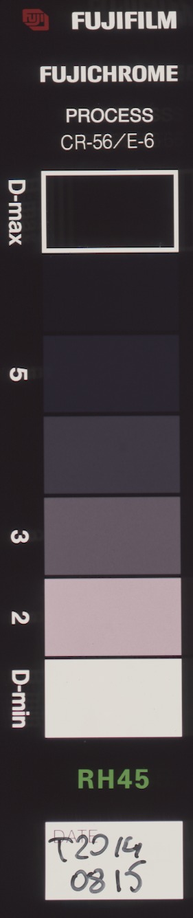

Oh, yes, I'm familiar with this little strange booklet. I do correct pH of CD with NaOH, so my slides looks good on the light table. But I estimated the correction on the trial and error basis, and I want more scientific approach, so I bought control strips. The strips looks bad, the slides looks good. I'm perplexed.

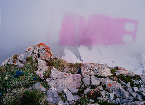

BTW, sometimes accidents happen:
Over the years I must have made almost any processing error you can possibly think of, yet most of my slides look ok. These control strips are brutal.
