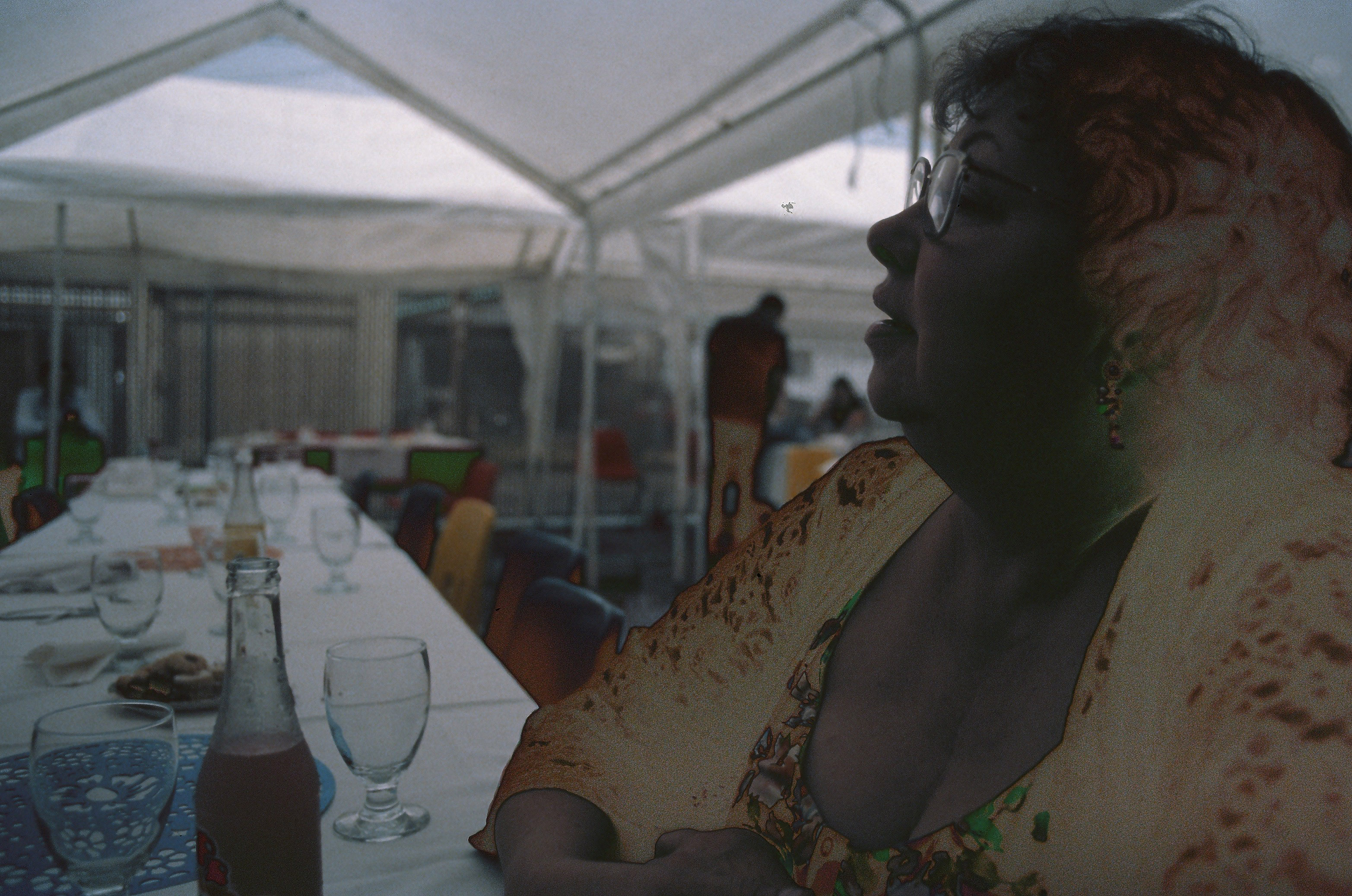

hi guys! I really messed up on developing e6 the other day. :sad:
I got new chemicals. I used to use the tetenal e6 kits, but now I'm using the belini 6 step.
I developed 9 rolls with no issue. prob a week or two gap between the first set to the second. everything came out fine. but when I did the last three (the one liter kit claims a 12 roll capacity) they seemed to have had an issue during the reversal process.
what I tried:
1) re fix
2) re pre bleach, wash , re bleach, wash re fix
3) re do the whole process with 100% fresh chemicals. and the results remained the same.
the negatives have reddish opaque regions that to me seemed like retained silver at first on all the spots that turn up odd in the image.
anyone have an idea of waht I did wrong, and what I can do to prevent this in the future. perhaps also how I can rectify this is it is at all possible.

My first thought (always) is 1st developer is shot. Secondly did you run 2 min wash between 1st developer and reversal bath?

ok and is there a way for me to determine if the 1st dev is shot from visual or scent? or must I do a control strip/process something first?
I have a filmomat for the e6 so I have it set to take in, rotate, and push out water a few times between most all the steps as according to the directions. do you have advice on a better way to set that up?

To my eyes, this looks very much like very expired slide film. Is this correct?
If not, I would suspect the first developer is almost totally expired. I don't think it is an issue with reversal.
The Bellini kit is not really capable of processing 12 rolls per liter. They have even changed this in their webpage to 9 rolls per kit. I would say 8 is the maximum, and only when solutions are used three times max. Even the third ones will have a bit darkish dMin. Use one shot in rotary, or twice with Jbob 1500 series tanks having smaller filling requirements that will allow this.
Perhaps the reversal chemistry (stannic chloride) is dead….

1st developer capacity needs to be reviewed. 12 rolls per liter without replenishment is nuts.
They did. The newest version of their fact sheet claims it has only the capacity of 9 rolls. My oen estimate is 8, if used one shot in Jobo in rotary processing, or max twice in Jobo 1500 series tanks (ą liter for 4 rolls, or in 500 ml quantities for 2 rolls at a time. Claim for 12 rolls is more likely to come from the marketing departement. And it should be clearly stated it does not mean you can use a liter of solution 12 times for developing a single film at a time. Not even 8 rolls. Also, if developing by hand using Kodsk style agitation scheme, as Bellini suggests, about 30 seconds should be added to the times published by Bellini.

Otherwise, the result is kind of weird. In places it is reversed, in places it is negative. And there is an effect similar to solarization. so I assumed it could be from the reverse process...

1.Yes rev should never get reused,may caused by this reason.I always think bellini is very unresponsible to suggest their customer to reuse every chem incl. rev
2.shouldn't get this result by just reuse developer,unless chem get polluted

This kit can process about 8 rolls up to acceptable standards. 12 rolls is too much. For processing 8 rolls, it means either one shot use in rotary processing, or using the solution twice in Jobo 1500 series tanks inverting manually. For Jobo tanks, you can load easily two 120 films in one reel, as they have the separator clips. These tanks can process 4 films with one liter, or two films with 500 ml. You can use the solutions for 3 or even more times, but it shows in the results. Also, E6 chemistry does not keep for half a year. It is not one week either, but the solutions will go faster than C-41 chemistry does. With Paterson and similar tanks, you will need more solution to fill the tank properly.

For example, surely processing 4 (E6) 120 films, one by one in 500ml of solution over a couple of days is barely different from processing them in two batches, with two 120 films loaded in the spiral each time and the same 500ml of solution?
I doubt it's so similar. The difference is due to halide buildup in the first developer. If you process everything all at once, all the film will 'see' the same fresh developer at the start, which then gets progressively 'contaminated' with development byproducts during the development session. By contrast, if you process rolls one by one, each roll is processed in essentially a different developer (one with progressively increasing amounts of bromide, iodide and chloride). The latter approach will be less consistent than the former.
