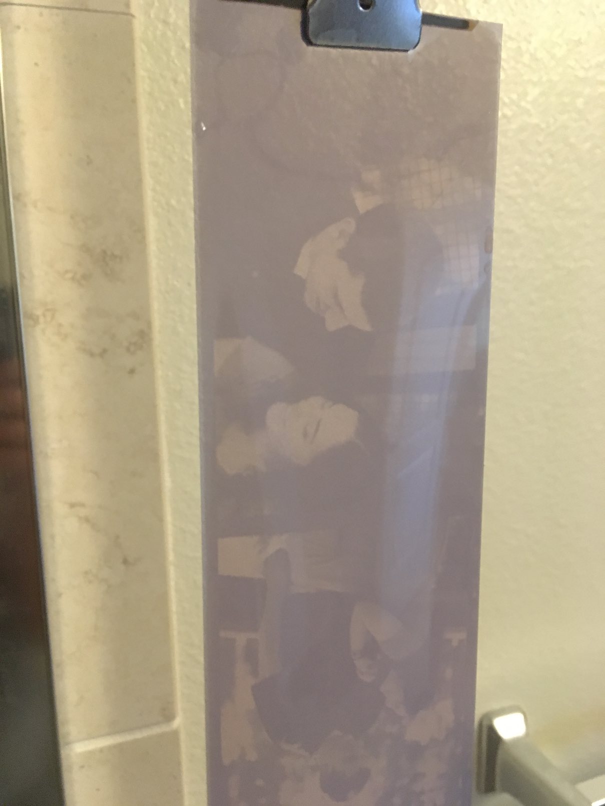

I just tried developing my first roll of e6 film and it did not go well. I tried my best and yet I ended up with what appears to be a positive image but with nothing but a purple cast for color. This makes me think my problem lies exclusively in the color developer process.
I'm using arista rapid e6 chemistry. I tried developing Fuji Provia at 85°F. I ran my tap out till it stabilized at 85° and I had a tub of water with an aquarium heater in it that I let the chemistry bottles float around in to stablize their temperature and I held my Patterson tank in the water during developing.
I'm fairly certain I mixed the chemistry right, the only thing I'm not 100% confident in is that temperature didn't shift throughout the process. I only say that because I didn't have a live readout the whole time.
What I'm curious is: I just want to know if anyone can give any insight as to where I went wrong. I would love to try again but since I don't know exactly what to change on my second go, I don't want to do exactly the same thing and get the same result. Or more frustratingly so: do exactly the same thing (as far as I know) and get a different result!

I have never tried the Arista Kit and never processed at 85°F, but would recommend the following:
  1. Run the process at 38°C/100°F next time, that's the recommended temperature for E6
  2. Extend E6 CD time to at least 6-8 minutes. E6 CD runs to completion, so there is no such thing as too much CD time. Standard CD times from authentic E6 kits are 6 minutes for fresh chems, no idea how Arista got these rather short times. Maybe it works with some films and not with others.
  3. Do the next test with a short clip. If you somehow made an error when mixing your process chems, no amount of fiddling and process changes will yield acceptable results. Expose one whole test roll with the same subject matter, ideally something which also includes some neutral gray area, and use this test roll for making short test clips of about 2-3 frames each. These short clips usually hold on to the spindle even with inversion processing.

I'm a total noob, but looks like your color developer is dead. Even at wrong temp you should get something better. Did you use distilled water in your developers and washes? Was your developing container totally clean?
Here's the process: pre-rinse (1 minute), developer (worked for you), fill up and rinse out container several times at same temp 38*c, colour developer, rinse several times, blix, optional stabilizer.
It looks to me like the process failed after the developer part. Did you rinse several times at the correct temp? Is there any chance your colour developer got contaminated?

Thank you both for your input!
I will! I ordered the Tetenal kit that doesn't let you develop any cooler. I got myself an electric burner that can be set to 100ºF so hopefully that will maintain a pot of water that I can hold my tank in whilst also heating the next bottle of chemistry.
Good to know! I'll let that stuff stew for awhile next time.
Thats what I would've thought but I wasn't sure. I didn't use distilled water, just tap water. I washed the beakers fairly well, the graduate the color developer was in was previously used for my home-made stop bath for B&W. Perhaps it had residual acidity that killed the developer. I followed the procidures very closely, I think a contaminated color dev is the culprit. Still gonna go with the Tetenal kit and go to 100º, but I also ordered new graduates and bottles.
