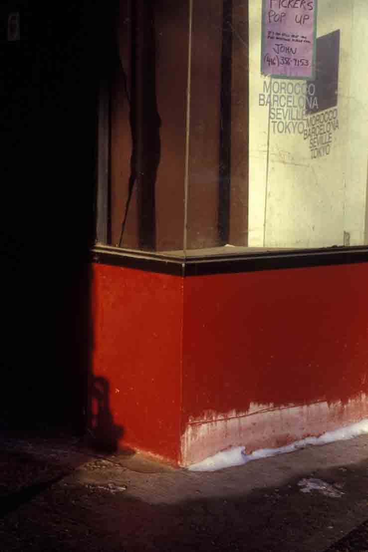

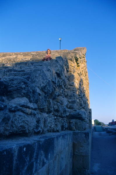

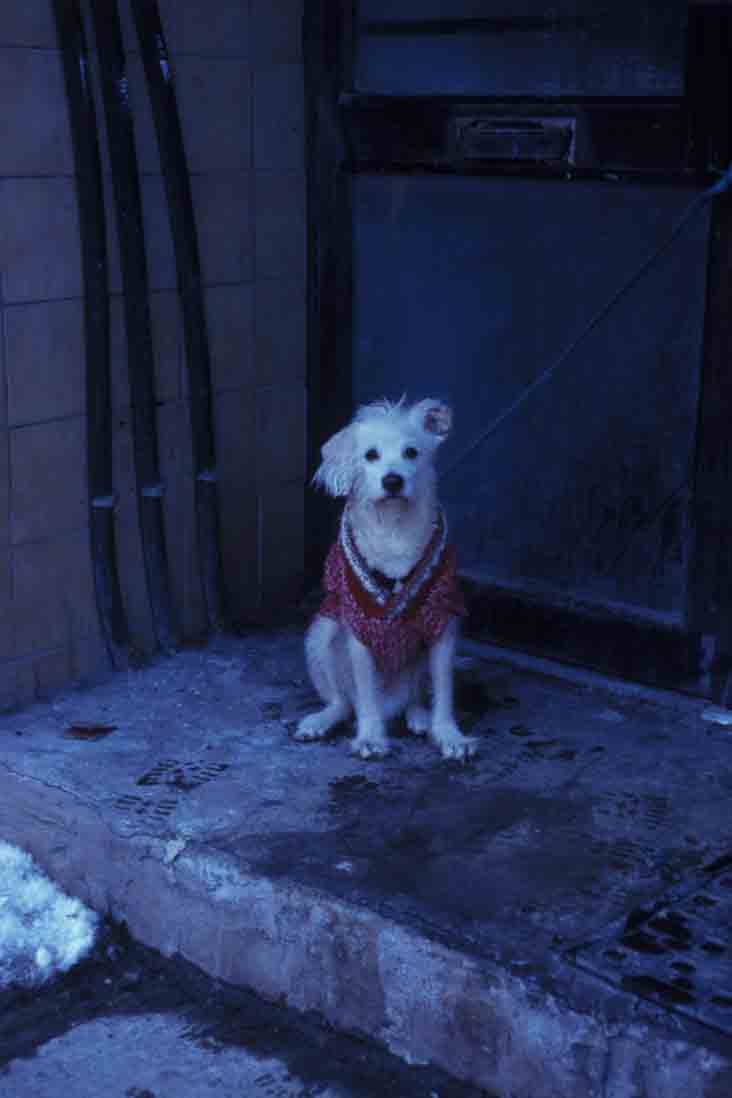

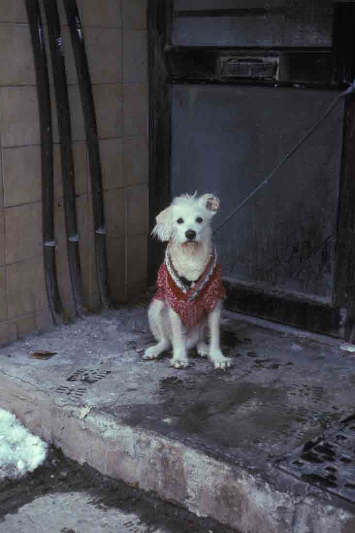

What weird is that the colour balance (is that what it is called? ) looks good on a few of the shots. Ive included pic 1 to show this. The reds look good and there is no bluish tint, but then on most of the other shots (on the same roll) still have that bluish tint to them. Pic 2 shows this and i've included pic 3 that shows the difference after I change the white balance in Light room.
I know its tough to diagnose this due to all the different variables and running it with the Jobo recommendations has made a difference, however anybody have any idea why some of the shots would look good and others are still showing this problems when they are on the same roll? Thanks in advance.

That image of the dog (second image) looks like it was taken in the shade, whereas the store front (first image) was sun lit. There is a good chance that the color temperature in that dog image was off to begin with, and the saturation of slide film would amplify the bluish character of the light you had there. Add to that the extra contrast you get from overdevelopment ...

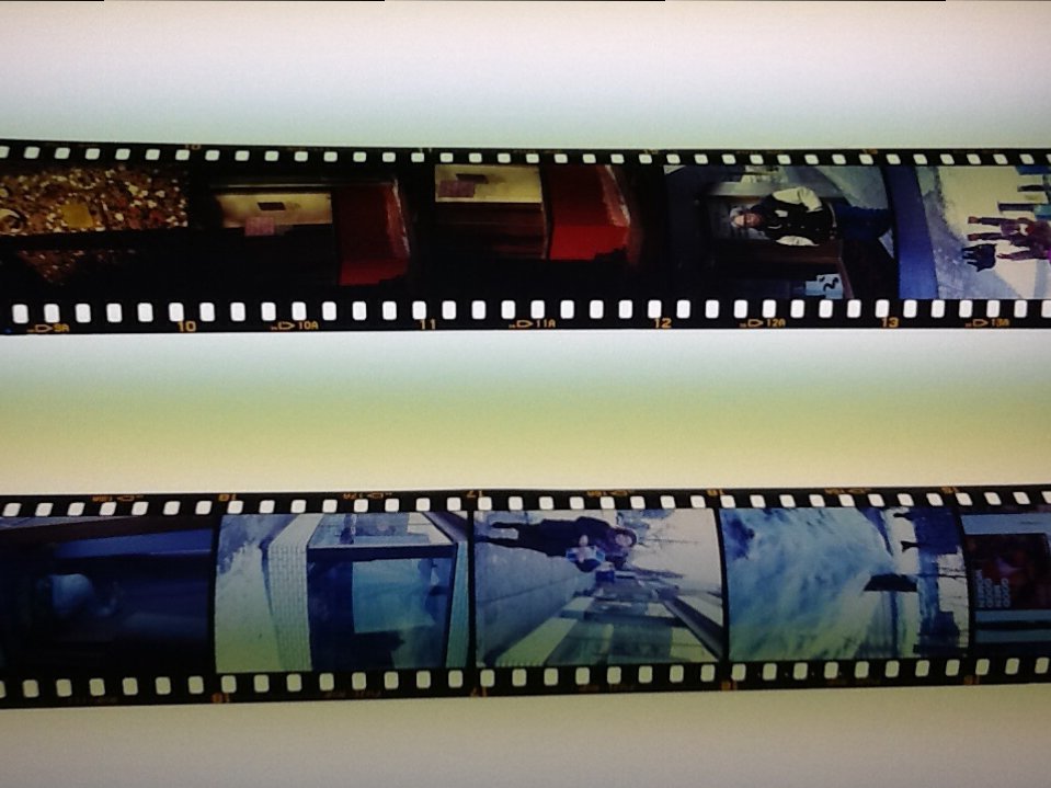

Like someone else said, shooting in shade will yield cooler slides but yours looks excessive and you said it varies on the roll. Post a shot of a section held up to a window or on a light box so we can see several frames in a row.

So frames 9,10,11 turned out very nice, but starting from 12 onwards there is a heavy blue tint. I do remember that it got cloudy really fast but I have a hard time believing it would get that blue in the shade. I'm pretty sure the exposures where correct on most of them, and besides underexposed should just have a lot of dead blacks no? I really don't know what is going on but maybe the previous comment about the slight blue cast being amplified due to the high development time might make sense. Let me know what you think bill.

Look at this slide scan. The image was taken not at but near sunset with otherwise blue sky. Kodak E100VS slide film was used, the scan represents what the slide looks like.
It's amazing what our eyes can compensate for, and this applies to both brightness levels and light color.
