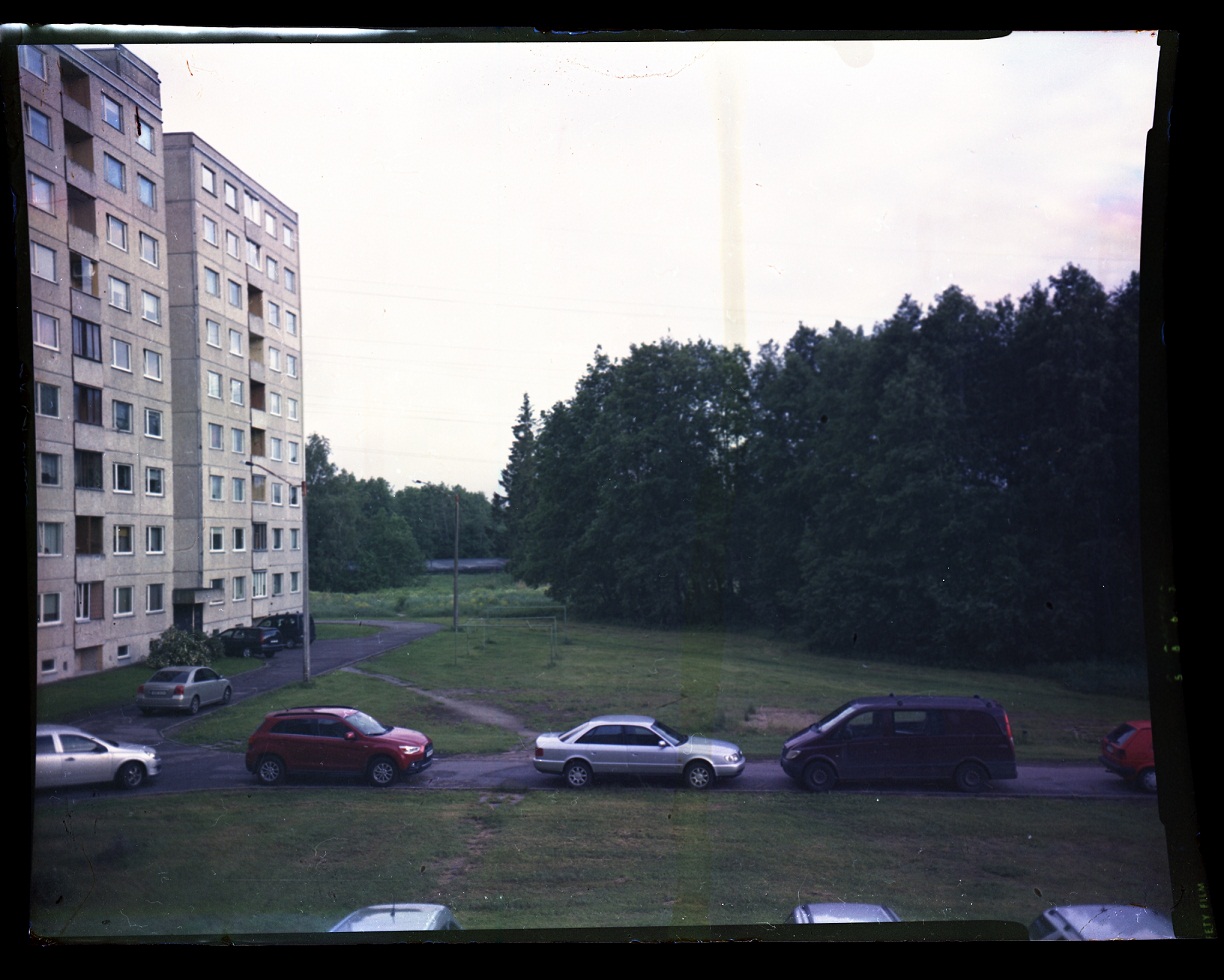

I got this yesterday, 10 minutes in ECN2 soup at some 23 degrees Celsius. There is a lot of emulsion damage there actually, even from careful handling. And as said, the formalin pre-hardener works like a charm (even without the sulphate!) but ties up the magenta, so a cut from a roll ran through the chemicals resulted in turquoise color, instead of black.
