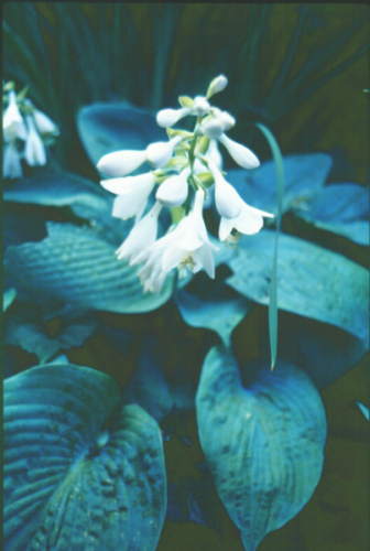

Here is one of the 35mm Ektachrome Slides. Best I could do with the crappy scanner from work. However, except for the noise in the shadows, colors are pretty accurate, but density is a bit MORE on the scan, but not much. Best I could do...

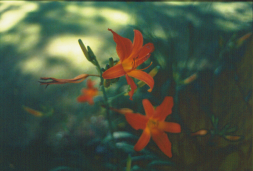

one more...

So, after looking at the slides above, do you think dilluting the reversal bath to 60% and adding the sodium hydroxide to the color developer would solve the majority of the problems in these slides?
Again, thanks!
