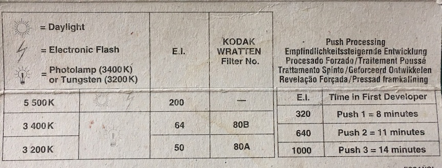

Tetenal recommends a 25% increase in first developer time per stop. For freshly mixed chemicals (6:15 first dev time) that works out to 12.2 minutes. That certainly would seem to be a reasonable starting point.
I've often shot Provia 400 at 1600, and it turns out beautifully. I don't believe I've ever gone to 3200, but see no reason that one more stop would present major issues.
