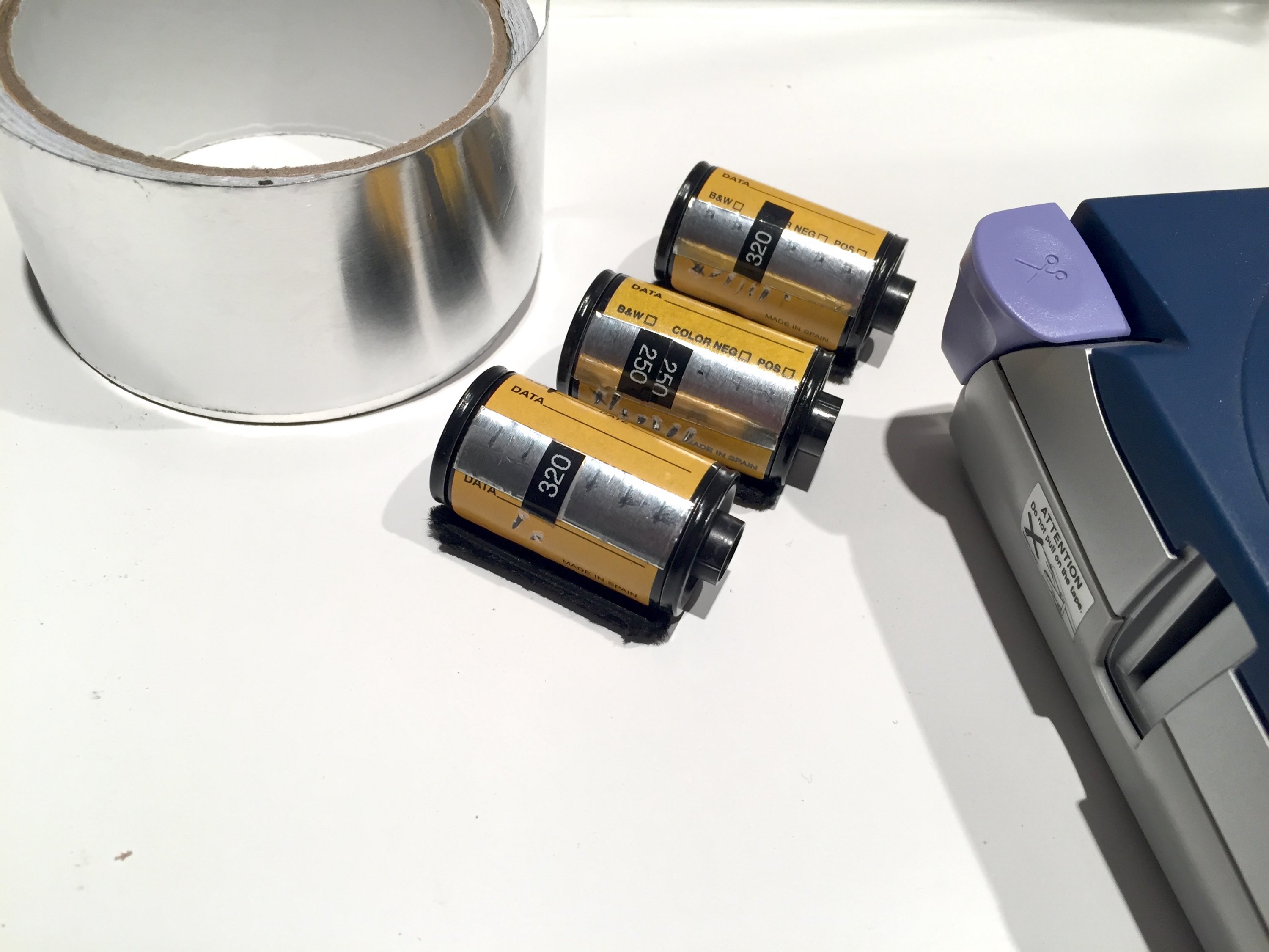

I made DX labels pretty easy with some aluminum tape and a label maker:
img_1058-jpg.259634
