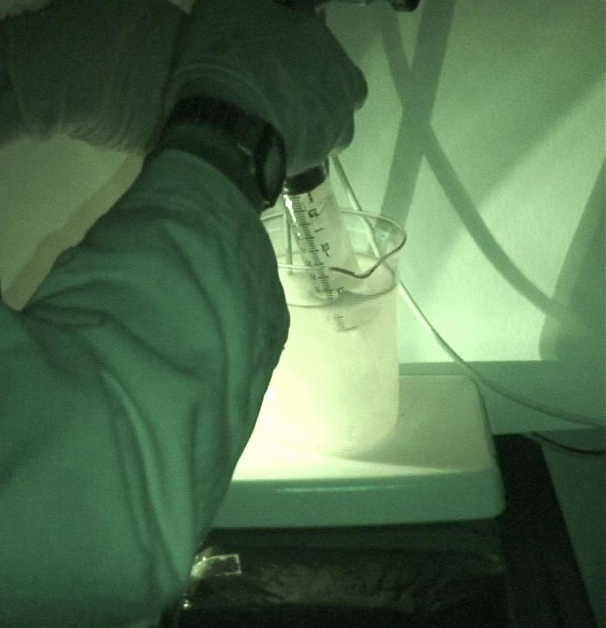

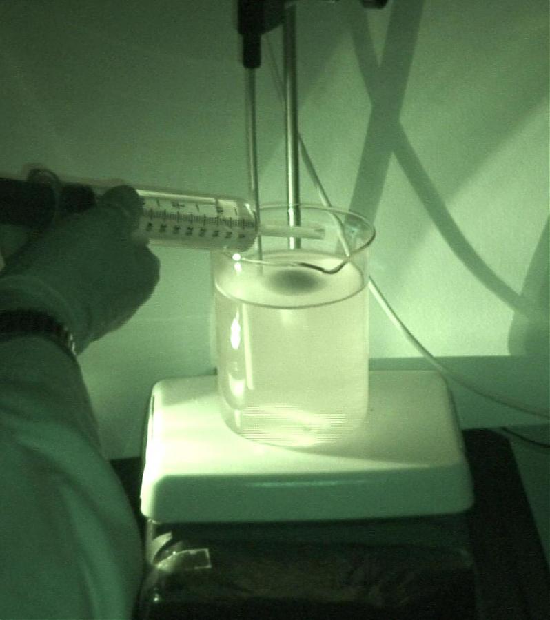

Making an Azo type emulsion - still from DVD
With my thanks to Ben, here are two stills from the DVD in progress.
These pictures were taken with a red flashlight safelight and my normal yellow safelights. The camera was in IR mode, so the emulsion is hopefully not fogged.
The first picture shows the syringe posed over the beaker before precipitation starts and the second shows the precipitation in progress. Hopefully you will see the white cloud of emulsion being formed in the beaker.
This was a 600 gram make of the emulsion which should make about 100 8x10 prints and should keep for 6 months. I made 2 coatings which are waiting to be tested.
PE

That's great! I love the mad scientist side lighting!
Kirk;
Thanks.
That is the same red filtered flashlight you held for me during the workshop and I'm making the same formula as I did then. Only here, I have it balanced on another object. You were not around to help me. :sad:
