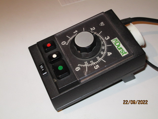

I have a Durst Enlarger Timer that I would like to do a spot of preventative maintenance on.
It is electro mechanical and quite clunky when the switches operate.
It must be thirty years old at least.
Could anyone tell me how to safely open the case, the only screws visible are holding a cable grommet in place. No other screws in sight.
There is no model number on it, so I hope someone recognises the model and can advise accordingly.
Thankyou in advance.

Looks like a Viponel s15 timer...

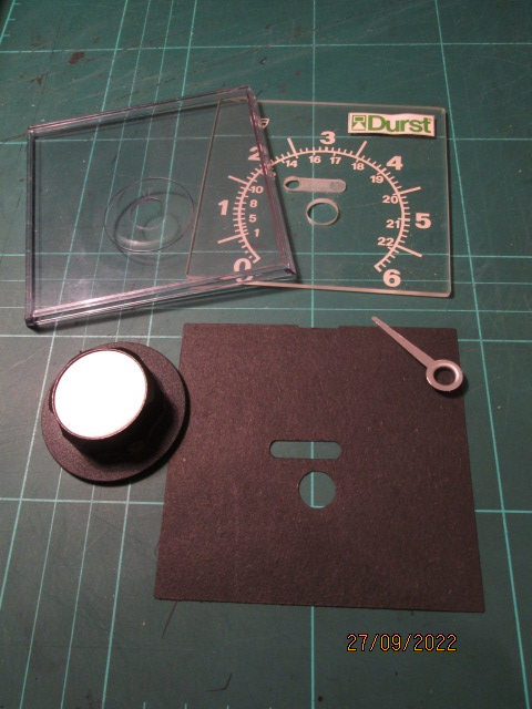

A few days later I attacked it again via the dial and finally got into it.
FIRST DISCONNECT FROM THE POWER SUPPLY.
Undo the grub screw in the side of the rotary setting knob. Lift off the knob.
The clear dial cover will then lift off.
Note the position of the setting hand. It will make things a lot easier when reassembling.
The setting hand can be levered up using a couple of suitably sized screwdrivers. Place a couple of pieces of rigid plastic under the screwdrivers to prevent damage to the clear plastic from the screwdrivers.
Lift off the graduated plastic dial.

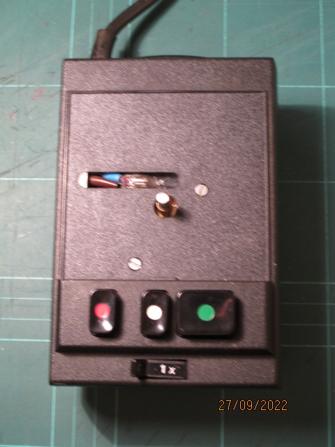

Then the bit that I did not find first time around....... There is a matt black card held against the timer body, held in place with small pieces of double-sided stick tape. I could not see this in my not to well lit shed.
With the dial, hand and card removed you can see the neon and two screws.

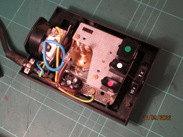

Remove the two screws and you can then lift off the top half of the case.
I gave the bearings and push buttons a quick oil change and used some contact cleaner on the timer contacts.
It does take a bit of tweeking to get the timing back in synch using a separate stop clock.
Reassembly is just the reverse of what you have done.
