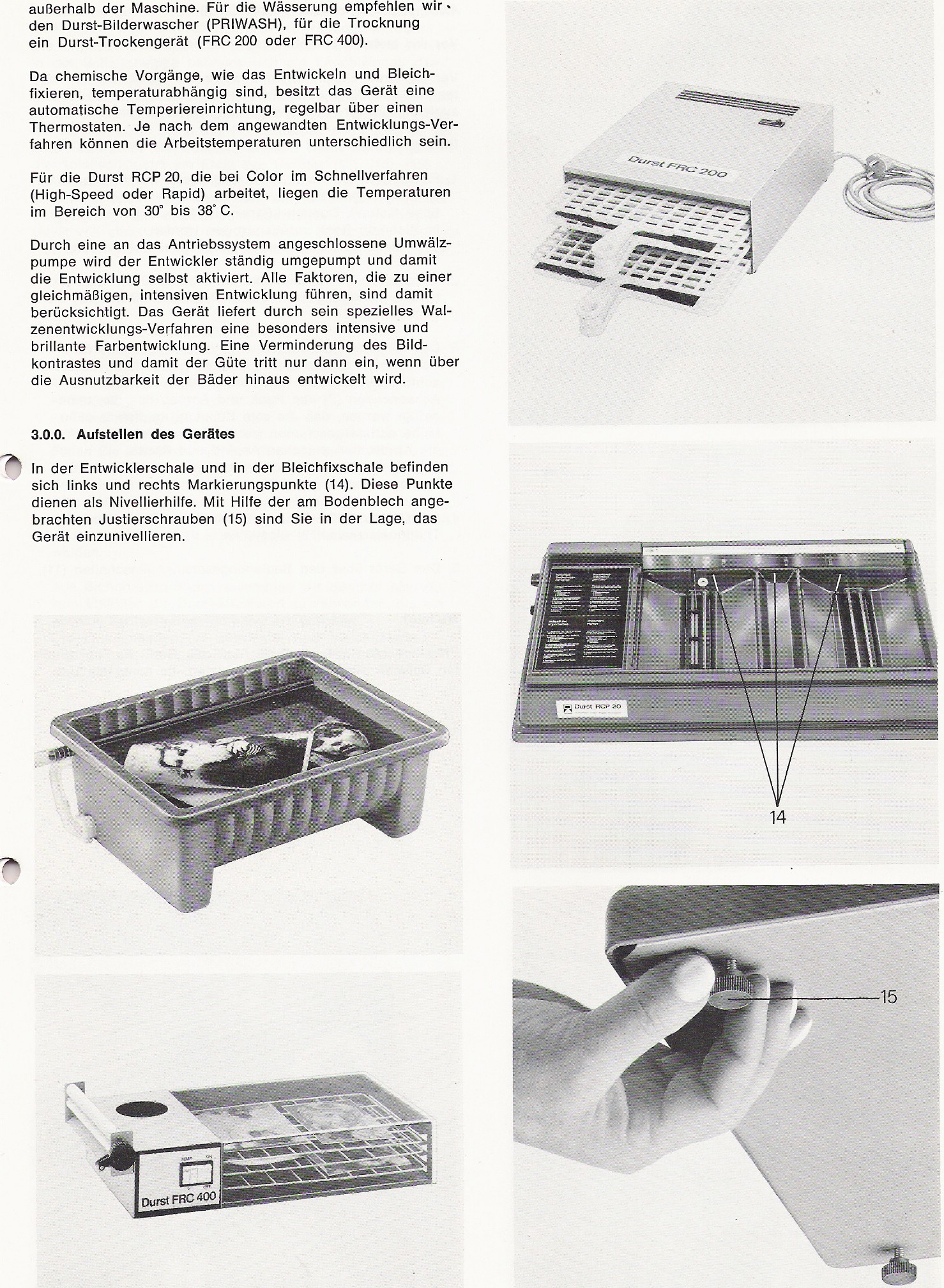

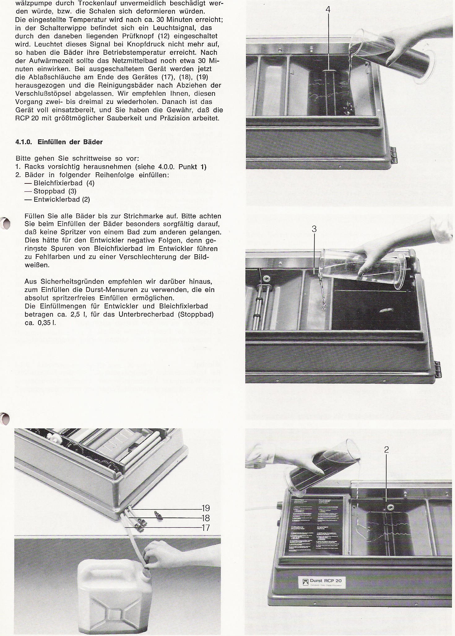

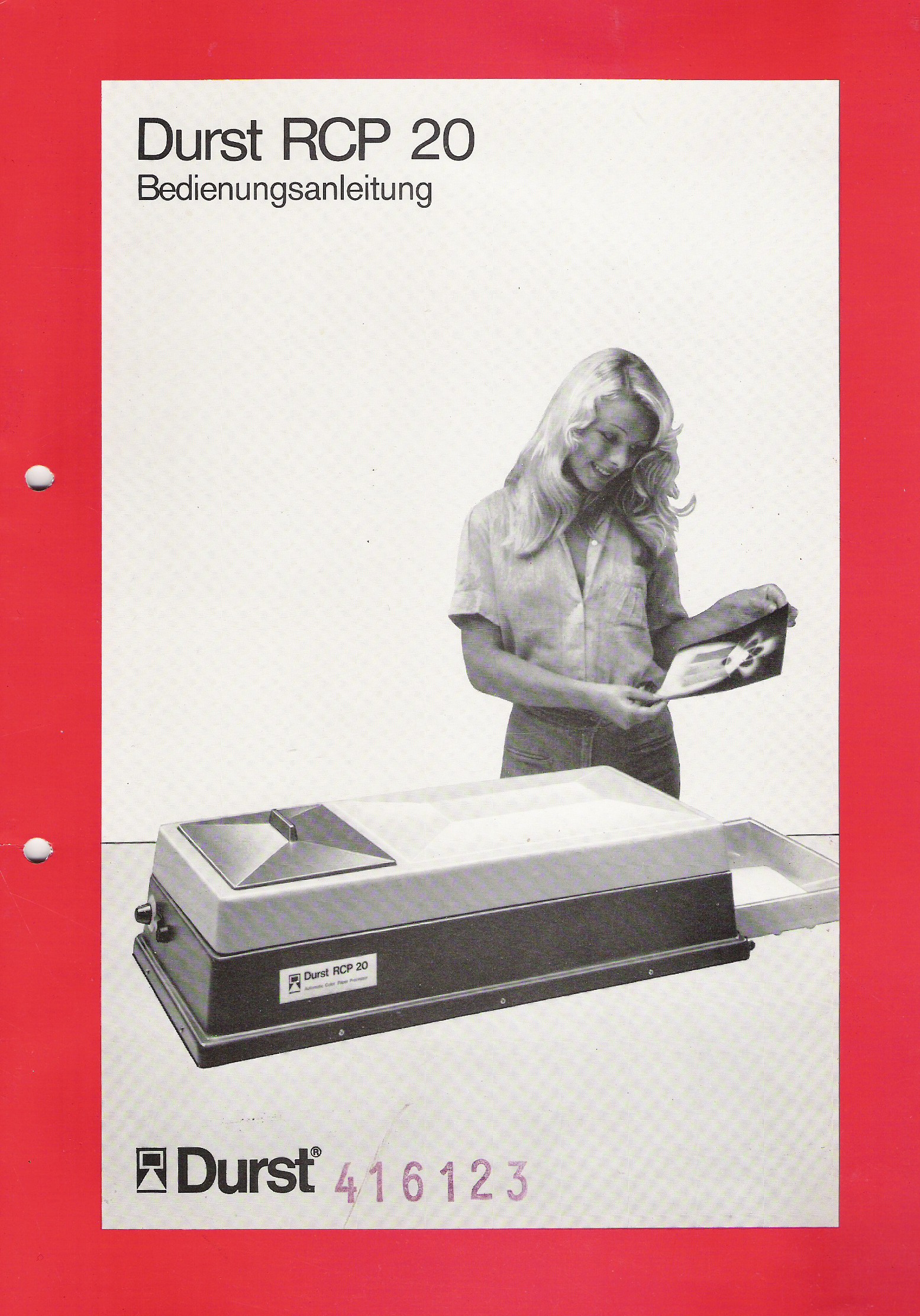

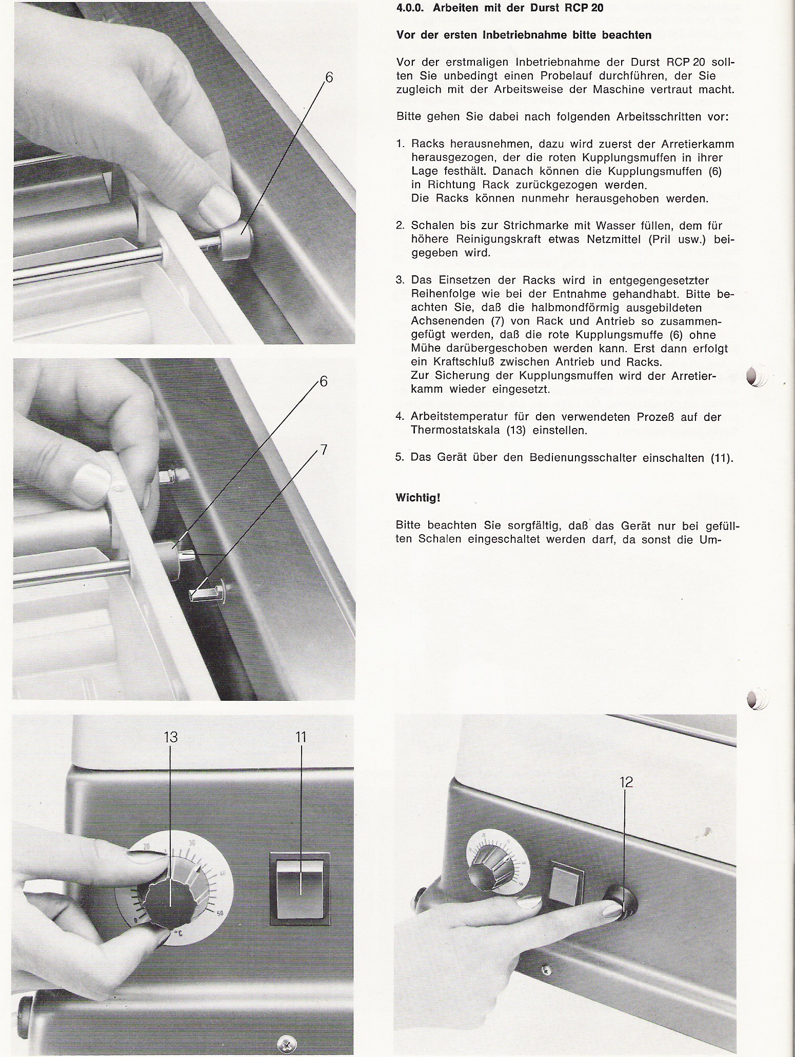

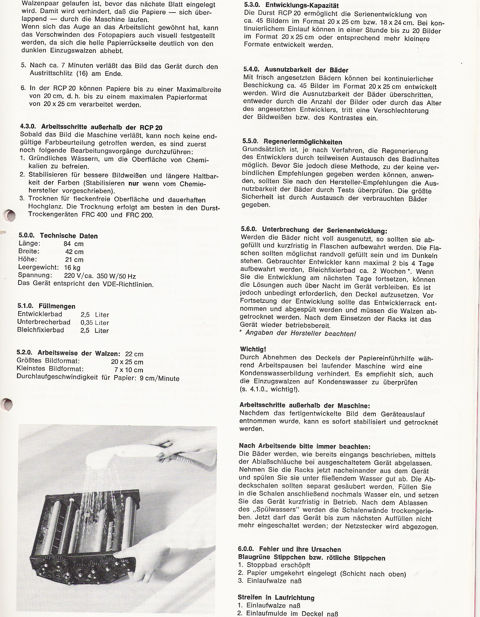

Hi... i´m in the same way, probably make tests in next two weeks. Put some images on german but it´s the basic leaflet. Good luck. Ah, the tanks it´s for 2.5L dev and blix see instructions...
