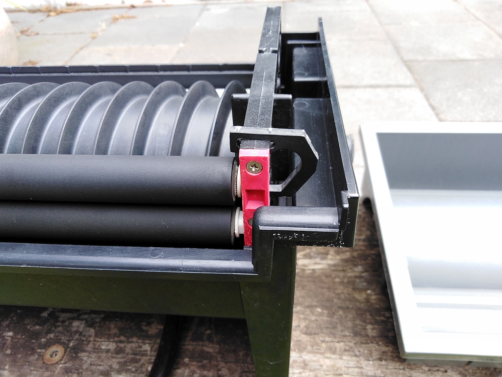

One issue with the Durst Printo, is the squeegee rollers, which are the last two rollers. These two are very soft and are pressed together by a pair of coiled springs, when the unit is stored the squeegee rollers need to be separated by a little plastic tab. Any kind of plastic will do, it just needs to be about 10mm wide by about 20mm long and around 2mm thick.
These two exit rollers if left together stick to each other and the whole lot gets stuck. I have a spare tank with a set of rollers that are stuck together, it is how I received them about 20 years ago as a gift. I kept that roller rack for spare parts, which fortunately I have not needed so far.
The top roller is spring loaded to press onto the bottom roller, which is driven by the gears. In the first picture you can see the coil spring and the back of the black spacer, which is directly underneath the white round thing.
the second picture shows more of the D style of spacer. I bought my Durst Printo new, only one roller rack came with the spacer, the other rack did not, so I immediately made up something and kept the exit rollers apart. The complete unit I received as a gift, was brand new never opened but about 10 years old. When I opened it the exit rollers were stuck together and still are stuck together. Durst quality control wasn't the best with these units it seemed.
When stored correctly and with the spacer on the exit rollers, the top roller is able to be turned by hand quite freely. the bottom driven roller will not move.
