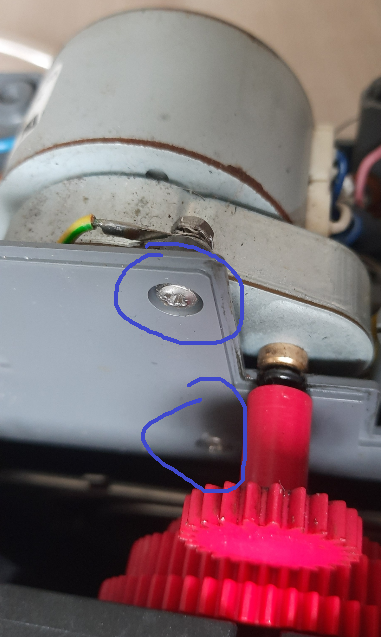

Yes, correct it's the motor mount.
When you talk about rubber bits, where exactly do you mean?
Thanks!!!

@RMB10 I'd check the motor mount screws first. If these are loose, the motor will likely wobble.
If these can't be fastened, or there's still play on the red gear after fastening them, open up the motor / temp control unit and inspect for damage to the plastic. Sadly, the plastic of the Printo machines doesn't stand the test of time very well and becomes a bit brittle.
Also check the black grommet/seal behind the red gear; this should be in good shape (obviously).
It was a generic reply about motor noise/mounts. Some motors are mounted with rubber grommets or bumpers to isolate vibration and noise from the motor. It seems the Printo bolts the motor solidly (at least most of the time) to the machine's chassis.
If your car becomes buzzy and vibrates with engine RPM the problem is, again, in the motor mounts. With age the rubber gets weak and the mounts collapse.

Thanks so much! Thats very helpful. I'll do as you said and see what happens!
