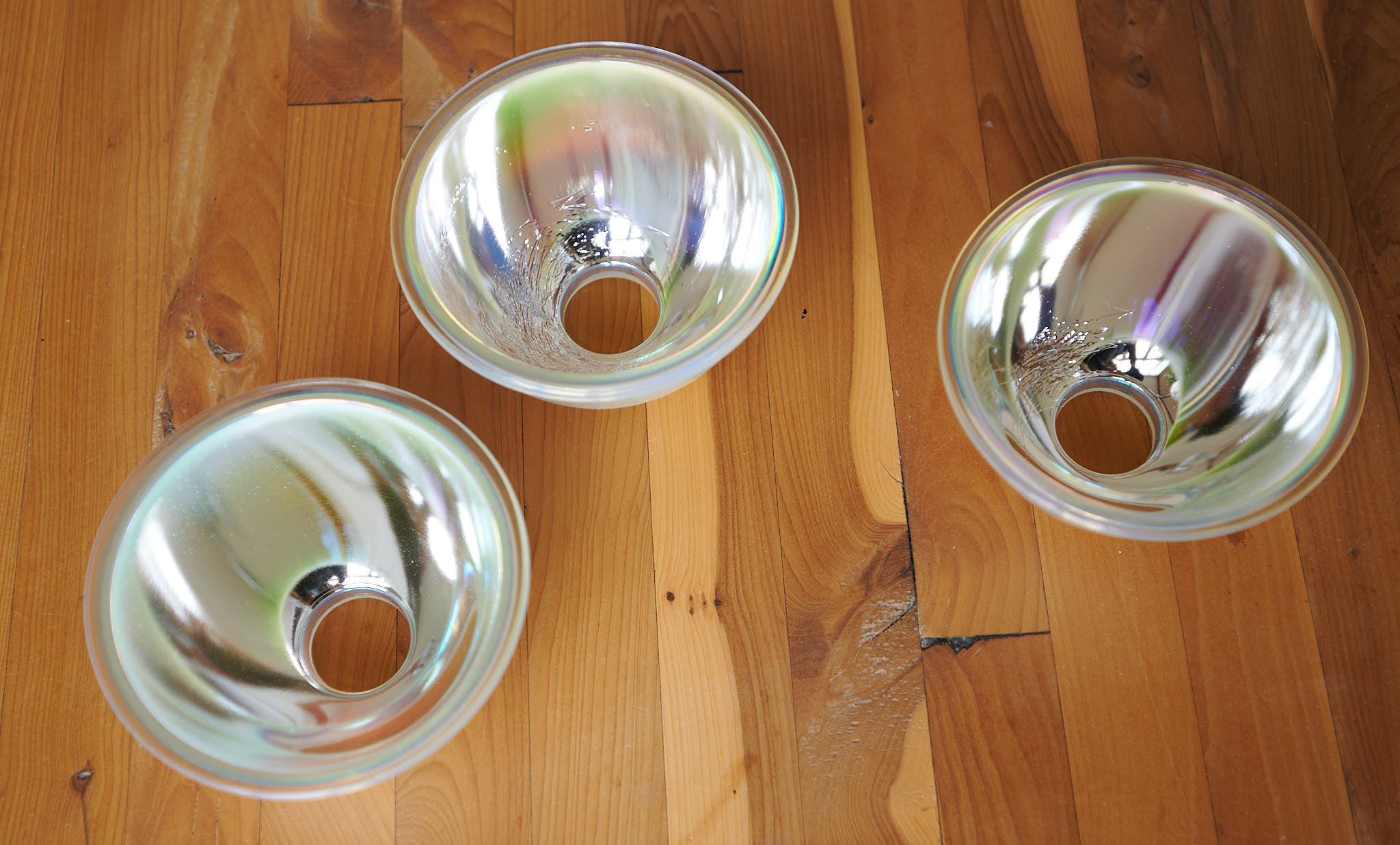

I have found these. One is in reasonable state. If you are looking for one.
Thanks so much for the fast reply Gary! Am guessing that the AC and CL will have a similar startup procedure so if there’s no neg carrier present that maybe explains something. The seller also has an Optopia CL with a neg carrier so we’re going to hook that up and see if it will run the start up procedure. There’s no lenses in the turret of the Optopia, will that result in the same issue?
Seller had said that when he first purchased the machines(two optopias, one Optimo AC)he tested them and the heads/bellows moved ran through the startup then the Opto Ecu wouldn’t really do anything. Could this be a programming issue or fault issue? Seller is not experienced with these type of machines.
Would absolutely love to get those reflectors or just the one that’s in good condition, just let me know what you like for it!
