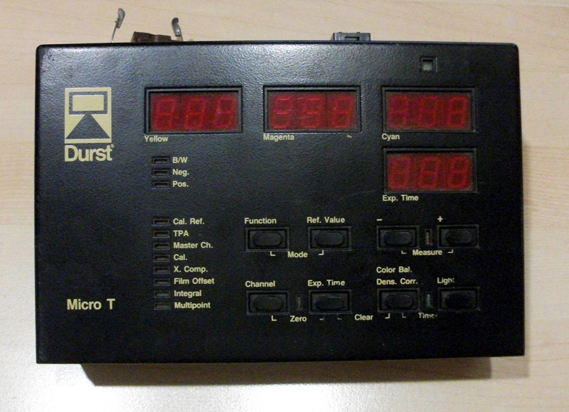

As I just started printing RA4, I thought of taking this analyzer out of storage and having a closer look. I am completely confused (of course I have no manual). Part of the confusion surely comes from my lack of understanding/vocabulary/etc as regards color printing. Some confusion must also derive from the crazy apparant complication that's in this 5x8 inch machine. It became quickly clear that some features only light up when 2 or more buttons are pressed simultaneously. I suspect this is a full featured color analyzer and enlarging timer. I just want to program it for neutral and density, and get on with it! Any help will be greately appreciated...

Luigi: I sent you an email with a zip of the docs I have for my analyser - not the same as yours, but to get your brain primed to figure out yours.
Do you have any reference negatives? a measuring probe, or a test print analyser (made by Durst also)? In the last part of my post there is a snip of the TPA function from briank.co.uk's site.
The basic operation is to select a mode, analyse a reference you hope to emulate in the new print, print a test print, and analyse the result against the reference colour that the analyser has electronically stored.
The reference does not always have to be just one thing. That is what seelcting different channnels does. I run a colorstar 3000 analyser, and it has 8 channles; later ones had 100.
I suspect you put it in b&w and only the exp time would light up.
(stick with b&w for now to simplify learning it's function with with just density to deal with)
Function would cycle you though the list of LED's down the left of the machine.
Mode would select B&W, neg or pos. Neg is c-41 printing RA-4, and pos is E6 or Kodachrome printing onto reversal paper (ie Cibachrome)
Master is usually a global adjustment applied to all channels. It is used to adjust for aging paper, different paper batches or shifting aging chemistry. Figure out what the range of valuse are for it and set it mid range to start, until you know better how the process reacts.
Ref Mode is likely used to bring up the reference value for the channel. You might press ref value multiple times to bring each of y/m/c active - and tune the numeric value using - and + to whatever value is supplied with the reference neg or grey card chip. Alternatively you might zero the three readings all at once to zero.
Then you would make a print with the test neg, and see what you get.
X comp - not sure
Film offset - might be like master, allowing you to adjust for different film base colours and ally the setting to all channels
Integral - where you have a scene with no good grey or grey analog like white or black to set the color balance, and then adjust the exposure. Put a diffusion under the lens when metering. In theory all colors integrate to grey.
Multipoint. Lets you make muliple probe readings, and the analyser then averages them for an exposure time. Usally you press a button to signal each point taken. Might be a button on the probe, or one of the keys on the analyser.
Hope this is enough to get you started.
