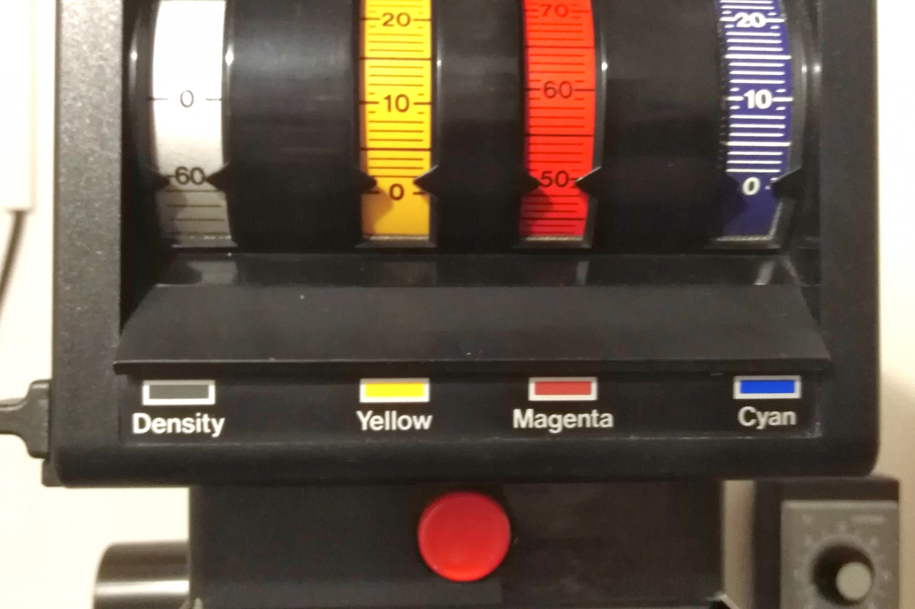

Hi there. I just aquired a nice durst m805 with a colorhead as i love doing ra4 prints. Its working as should but the only things wrong is that the reflector panel seems to be stuck. Its supposed to open for illuminating the 4 scales. Does anyone know something about this matter maybe? :-D

I should say that it doaent seem broke or anything ..just totally stock!

So i unscrewd the front and could varify that all the bulbs ( 4 ) are working as should but the plastic lid ( reflector) that should open , is totally stuck . So does anyone know if this should slide , open horisontly or any other way. I ask because it maybe can be glued and if i have to use force its crucial to know which way it open?

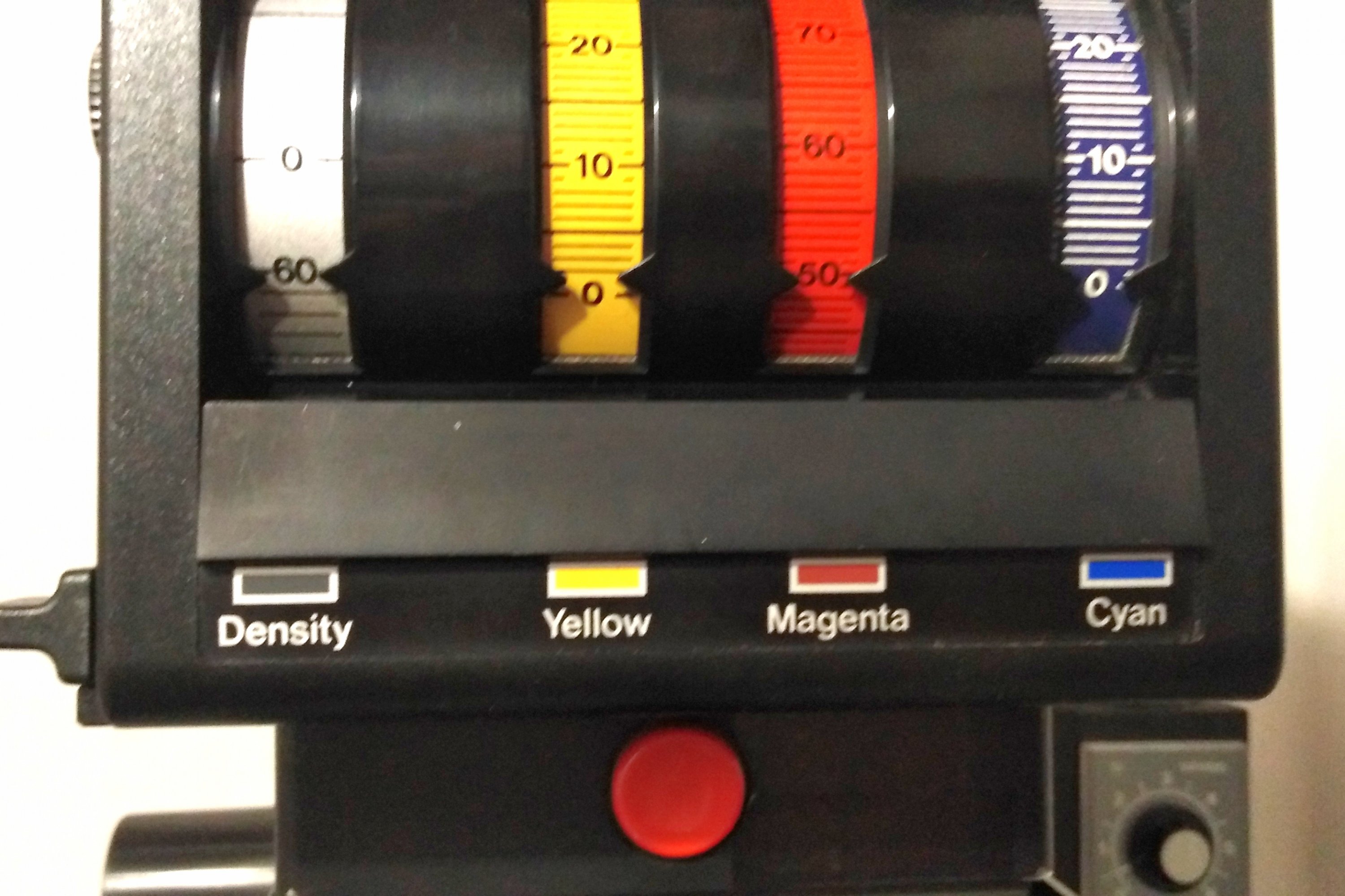

Hi! Mine was stuck too in the beginning, and it still needs some lube. Anyway I never use it, as the light is to powerful for my little darkroom.
Here's the panel, closed and open..

Wauw you are geat IBicus…just the thing i was looking for… Ill try and lube it… thanks so much!

But I am ignoramt on something other: the working of this flap (reflector) underneath the scale wheels is not even mentioned in the manual. What is it expected to do? And is it actually intended to be flipped?
