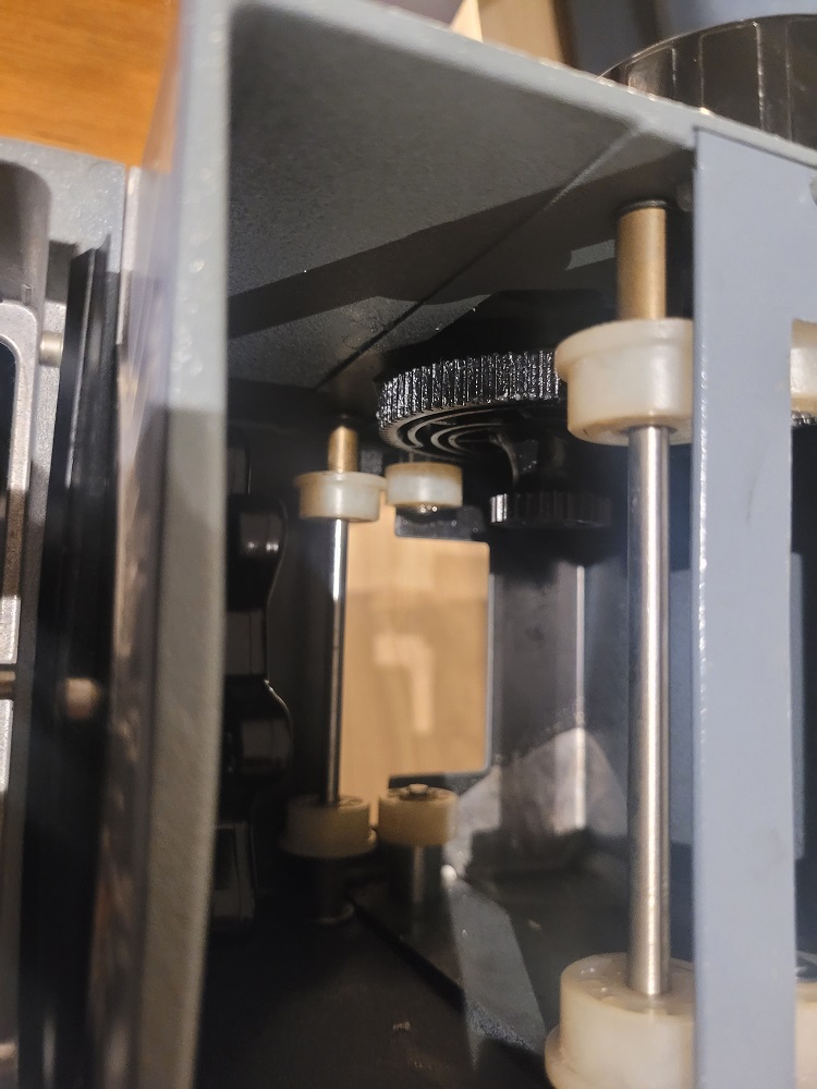

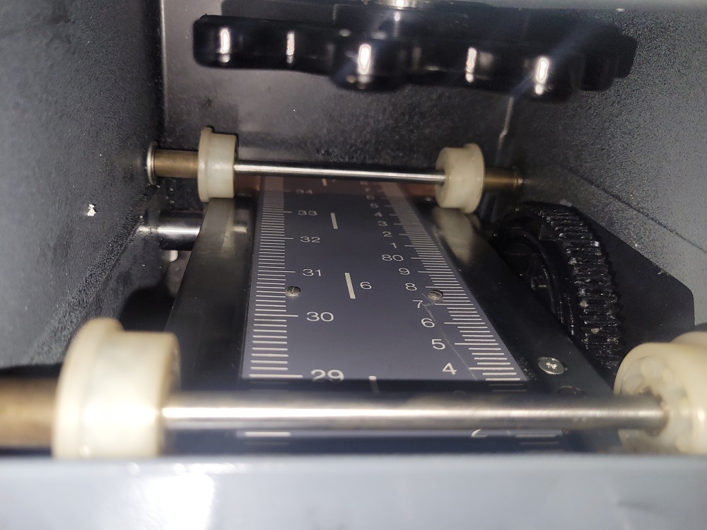

Hi everyone,
I'm new to the forum, and recently got back to developing my own film and hopefully printing after a long break.
I came across a durst m800 with a few accessories, and a few bits missing too.
The main issue I have now is with the lifting mechanism. The head tends to fall down, and the crank does not have any effect when trying to lift it back up.
I don't know how is the mechanism supposed to work so I am not entirely clear on how to see if something is missing. there is nothing blatantly broken.
It was allegedly working before the enlarger was shipped, so I suppose something might have been dislodged\lost when the seller dismounted it.
A couple of pics of the interior of the head are attached!
Thank you all

negativefunk
Aug 8, 2022
141
Spain
Sorted, albeit provisionally until I find a replacement.
The black gear actioned by the crank was slightly broken and didn't transmit the motion to the smaller one, that climbs the column.
I have considerable experience with the M800, including a few improvements. It does present a failing, and your problem describes it. The head is driven up and down the column by a crank which turns a set of gears located on the rear of the column. These gears mesh with two geared tracks running the length of the column. Unhappily these days, Durst made those gears and tracks out of some sort of nylon, which has hardened. The consequence is that it is common to chip teeth out of those parts. If you chip out enough teeth, that opens a gap in the mesh between the gear and track, which causes the geared wheels to let the head slip down the column. Back when Durst was still viable, you could order replacement tracks and gears at low cost. The tracks are held in place with a couple of small screws and easy to replace. Today, two problems: (1) Not available in the US. Maybe more so in Europe. (2) The Durst parts harden whether in use or stored, so new original parts are just as brittle now. I think I saw someone selling these tracks (3-D printed) on ebay not that long ago. Replacement gears, nylon or brass, should be available online.
