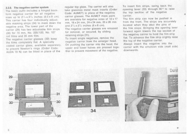

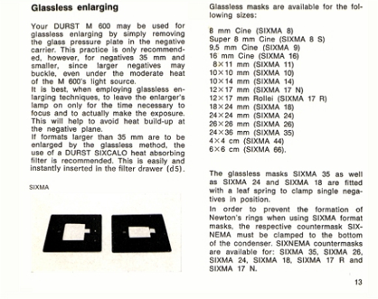

Thanks, @bunip, that's very helpful to know. Meanwhile, I found this useful snippet from the Durst M600 manual (presumably applicable to the M700 as well):

With setoneg you can't print without glasses or masks. If you like I can send you some pictures of the italian user manual.
you need either the glasses or the masks; you can combine them, glass over the mask. The red adjustable light masks included in the setoneg are for masking light around the negative in case you print for example a 35mm negative with glasses, or a 35mm with the 66Aumet masks, just to block the excess of light around.

That would be great, @bunip. After several printing sessions I see how a mask would make preventing light spill much easier, not to mention make positioning the negative much easier. Currently I'm using the adjustable pegs inside the Setoneg to butt the top of the negative against, which kind of works (no idea if that's why the pegs are there).
Do you know if the Durst Sivopar (Sixma, Sivoma) would fit in the Setoneg? These seem to be much more widely available than the 66Aumet.
UPDATE: Having read the section on negative carriers in the M700 manual, I found some related information I found helpful and thought I would share:
1) As @bunip mentioned above, AUMET masks should be the mask code used, there's no mention of the Sivopar mask pair I thought might work
2) The adjustable pins in the Setoneg are intended to correctly place film strips into the negative holder as I was using them.
Here's a screenshot of the said section:
